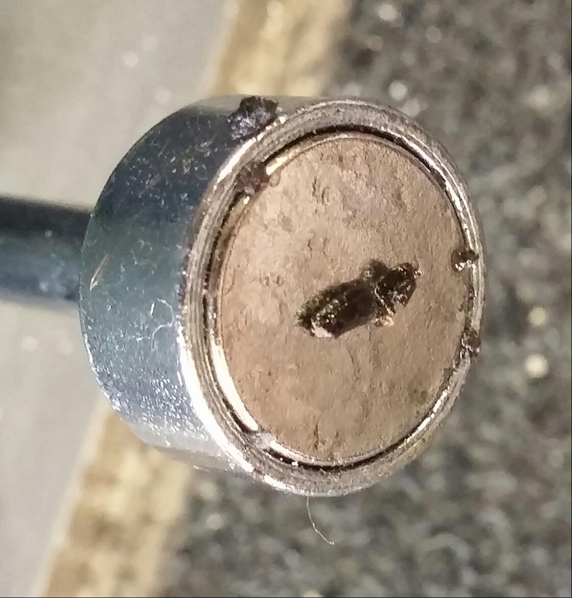

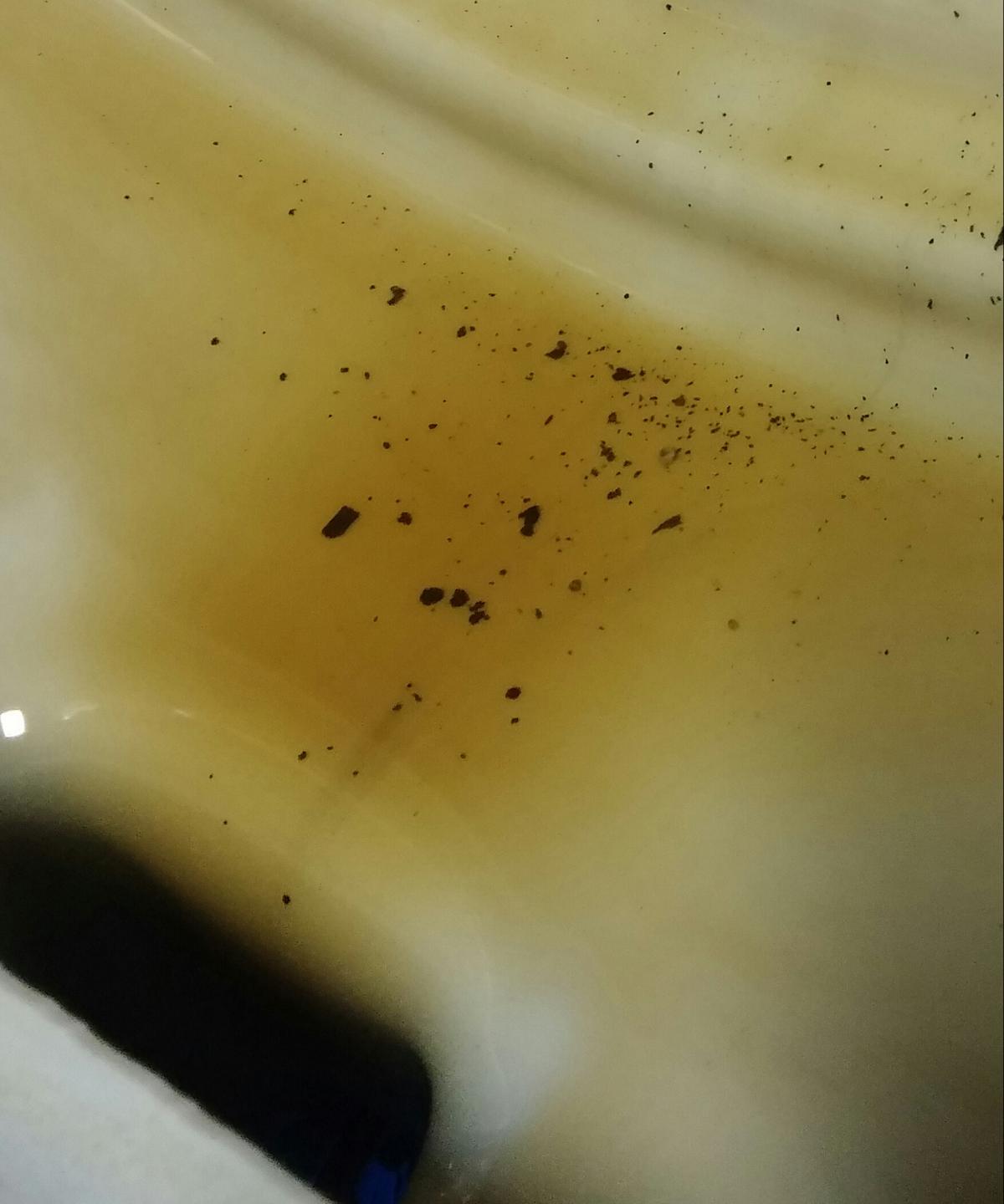

parapants Posted September 20, 2015 Author Share Posted September 20, 2015 First pic is the black chunks in my oil catch pan, they range in size from grains of sand to maybe 3mm. Second is one of the bigger chunks stuck to my pickup magnet, with a groove visible where I pressed my thumbnail through it. Quote Link to comment Share on other sites More sharing options...
Fairtax4me Posted September 20, 2015 Share Posted September 20, 2015 Vibration could be a seized u-joint. Pull the driveshaft out entirely and see if the joints move easily. Not sure about the crud in the fluid. There aren't really any gaskets in the trans. The transfer and extension housings have paper gaskets between them. The main case seam is sealed with RTV. Maybe some previous owner put some dirty fluid in it? Goop on the drain plug magnet is normal. Quote Link to comment Share on other sites More sharing options...
parapants Posted September 20, 2015 Author Share Posted September 20, 2015 Maybe on the dirty fliud. The previous owner was pretty fastidious about the engine oil, can't speak to his care of the trans tho. A friend who does a lot of motorcycle work just told me it looks like the synchro rings are dying, and now that I ponder it I can't remember if maybe I did have a hard time putting it into 4th once or twice and just didn't know what it meant, or if I'm just making up memories cause I have an idea to latch onto. Prop shaft is all out and all the joins move seemingly smoothly, except the tiny click I can produce at the front one. Dunno if that's a problem, I don't feel any significant false movement, just a click, but driving loads will be far tiger than hand loads. Didn't make noise while driving tho. Center bearing is also nice and smooth. Think I'm gonna go ahead and pull the trans out tomorrow and open it, what better way to learn eh? I'll post what I find out. Quote Link to comment Share on other sites More sharing options...
Fairtax4me Posted September 20, 2015 Share Posted September 20, 2015 Work synchros won't be terribly obvious. That's something you'll feel while shifting, but won't be visible when looking at them without disassembling the shaft and removing the synchro rings. If you're gonna pull it apart check the mainshaft bearing for play. Worn mainshaft bearing will allow the mainshaft to walk forward/back and can cause difficultly shifting into 4th. It will eventually cause it to start popping out of 4th and 5th. Quote Link to comment Share on other sites More sharing options...
1 Lucky Texan Posted September 21, 2015 Share Posted September 21, 2015 wonder if someone used the wrong trans fluid in the past? how many miles on this car? might be able to get a used trans with half the miles from a wreck to throw in it. Or, get some name brand non-synthetic GL-5 in the trans and just drive it. Quote Link to comment Share on other sites More sharing options...
