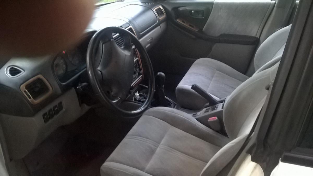

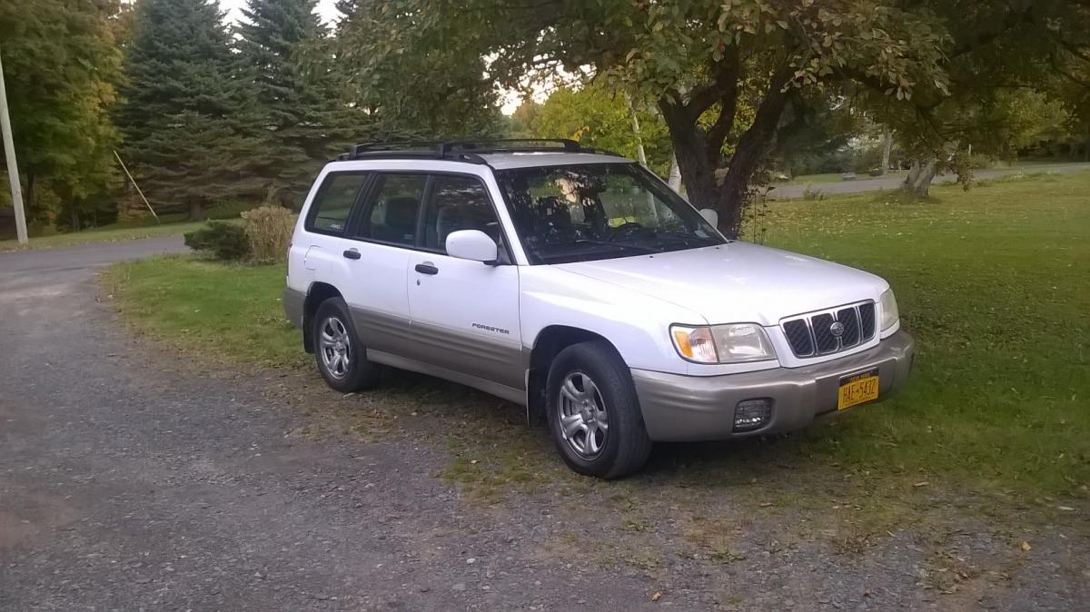

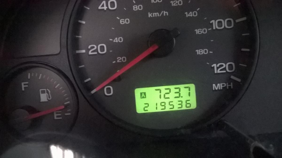

matt167 Posted October 7, 2015 Author Share Posted October 7, 2015 Picked up the car last night and drove it home.. It had a violent shimmy above 45 MPH that smoothed out above 55 MPH but it didn't get hot, the heater got hot and it stayed hot, didn't smell like coolant and other than a wheel bearing I knew was howling it was ok... Took it to work this morning in hopes that the shimmy was a wheel balance issue and it was pretty far out, but zeroed out.. It now is shimmy free and runs and handles like a slot car. So this is what $1,400 got me.. It's got little rust but very presentable. , little over 219k miles but it's solid underneath. Brakes are decent and the interior is pretty immaculate Quote Link to comment Share on other sites More sharing options...
AdventureSubaru Posted October 8, 2015 Share Posted October 8, 2015 219 is nothing for this motor if well maintained. I've worked on a few that have gone over 350k on original motors. At that mileage it has already had headgaskets done once most likely but unless they were installed improperly, should not be failing again. Check your hoses, check the edges of the coolant manifold, temp sensor etc and be darn sure it's not a leak. If the head gaskets are not the problem just run it. These are good motors. They don't stand up to abuse/neglect as well as the 90s ej22s but are still a 300k and 400k motor if cared for. Car looks sharp. Regardless of the path to get it running well, I'd say you got a deal! Quote Link to comment Share on other sites More sharing options...
matt167 Posted October 9, 2015 Author Share Posted October 9, 2015 (edited) The leak spray is gone, never was even able to trace it. the guy could have spilled coolant on the fan for all I know.. It's running GREAT, hasn't used a drop of coolant and it stays right on 1/2 on the coolant gauge.. I just changed the oil today which was dark but not bad. and pulled the instrument cluster to replace bulbs that were out, to find someone borrowed the bulbs and sockets for a different car. So it's off to the yard tomorrow for some sockets.. Also, the rear hatch latch is seized open. I can't get it free so I'll grab one of those too. I have it ziptied closed for the time being I've serviced some EJ251's with over 350k miles on them, so that's why I didn't think twice about 219k being high.. without that odo reading, I could tell people it has 100k on it and it would be believable. Edited October 9, 2015 by matt167 Quote Link to comment Share on other sites More sharing options...
