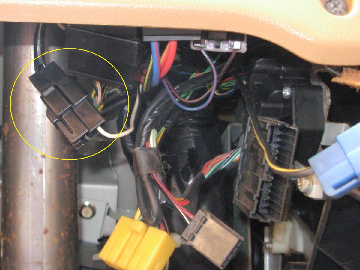

Kenneth1948 Posted November 12, 2015 Share Posted November 12, 2015 '91 Legacy 200k has been running well for about 12 months. Now I have an intermittent stalling problem. New fuel pump, screen and filter did not solve the problem. Not predictable, can run 10 or 15 minutes with no problem or stall every 30 seconds. Re-starts immediately. Sets "Check engine" light Previous post said this could be the MAF sensor. The car is supposed to have some diagnostics. I can't get them to work. Haynes manual says disconnect connector adjacent to diagnostics plug and turn on ignition. Check engine light does not flash. Not sure I have the right connection? I will try to post picture. Circled connector is the one I disconnected. Any help with reading diagnostics or probable cause of stalling would be much appreciated. John aka Kenneth Quote Link to comment Share on other sites More sharing options...

Kenneth1948 Posted November 12, 2015 Author Share Posted November 12, 2015 Herin lies the problem. I can't read the codes. This is a '91, it's an OBD I with "morse code" codes. When I unplug the connector, the code(s) don't flash with the CE light. Please see my post and photograph, I'm not sure if I have the right connector. Rodents chewing through the wiring remind's me of an A40 Austin van that belonged to a friend of mine, with a family of mice that lived in the back of the van. Thanks, John Kenneth Quote Link to comment Share on other sites More sharing options...

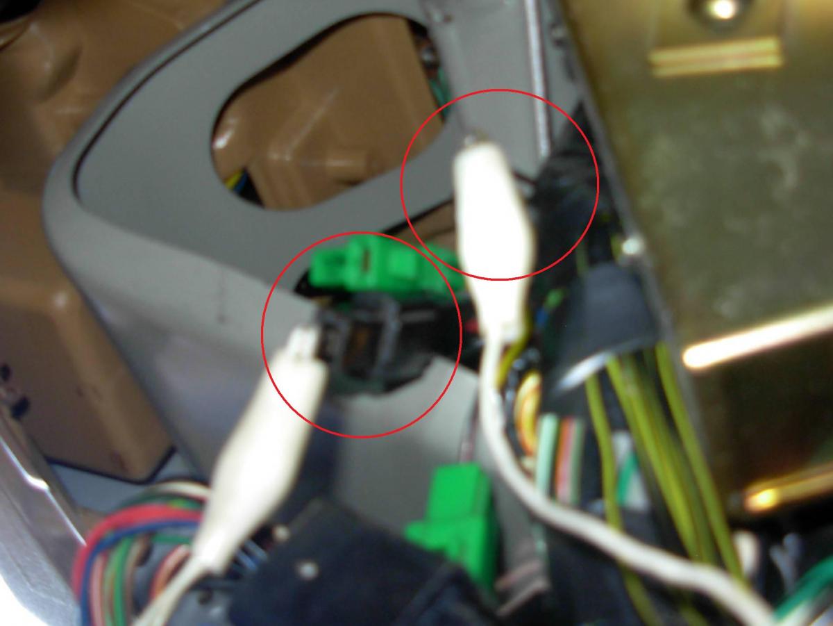

Kenneth1948 Posted November 13, 2015 Author Share Posted November 13, 2015 Identifying the OBD I Connections: The Haynes manual is no help whatsoever, it tells you to disconnect the connection, you actually have to connect it. And the description of the connection is inadequate. The link above from Mikeleda is very helpful. I ran into the problem that the wires on the 2 parts of the black connector were not long enough to allow it to be connected. I had to cut one of the wires, plug the connector in and jump the connection. The attached picture shows the black connector, connected together. The white jumper is connected with one clip right next to the connector. The other connector is connected to the cut end of the wire (you can just see the wire top right of the circle). Hope this helps save someone some time John Kenneth Quote Link to comment Share on other sites More sharing options...
