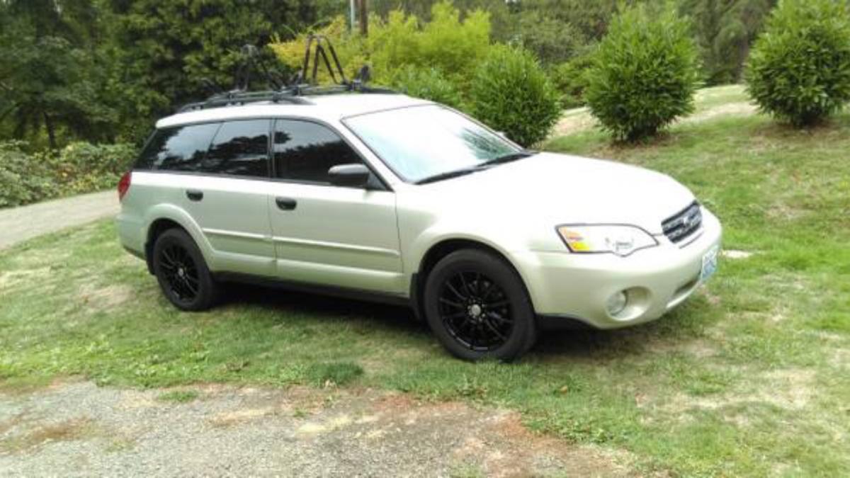

noahkanzig Posted November 19, 2015 Share Posted November 19, 2015 Okay, I am sure you're thinking, wow another vibration thread.... Hear me out at least. On my 2006 Outback 2.5i I have replaced: 4 CV Axles 4 Struts All New Brakes New Wheels New Tires 4 Tie Rod Ends Two Ball Joints With that said, I am having a vibration at about 60 mph and above. I have had two shops check for ANY looseness in the front end with no luck. LCA bushings show no signs of leaking or tearing. My only guesses are that the aftermarket front cv axles are causing the vibration as I have heard they are capable of, although they don't make any other noise or additional vibration under acceleration. Second theory is that it has to do with the power steering. When turning the wheel something about it doesn't feel super smooth or predictable. It's hard to explain but it's not always noticeable or there at all, usually only can tell when driving slow. Are there any other things that could be causing this? The vibration IS IN THE STEERING WHEEL ONLY. Once over 60mph the wheel vibrates back and forth about an inch or less each way. No noise associated with it just the feeling. And gets worse at higher speeds. Sorry for the long post, I guess the better I explain up front the less time you waste asking questions though! Any help is appreciated! Quote Link to comment Share on other sites More sharing options...
