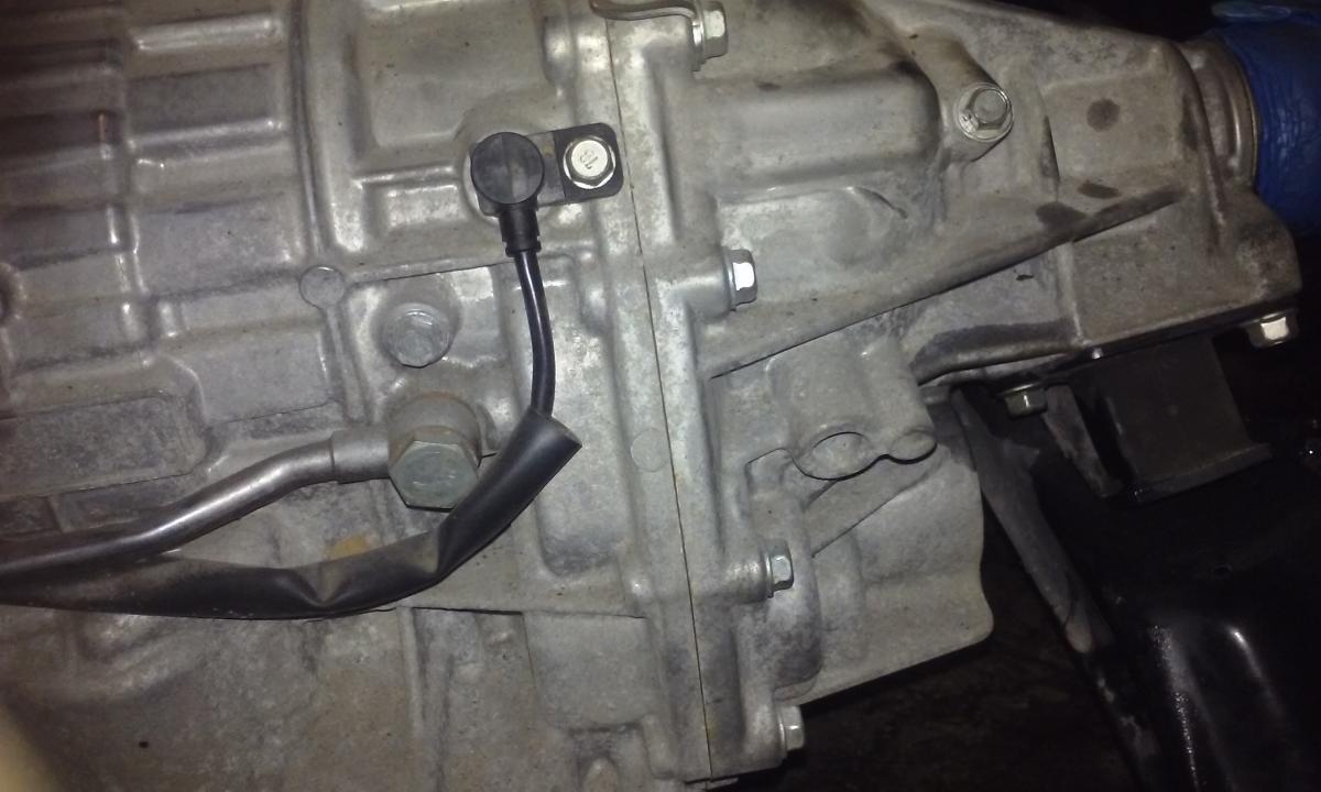

what is the difference? there are also some electrical differences. the 08 trans has a sensor on the tail shaft and a screw in filter. the 09 does not. it does have bosses for them though. it looks like it plugs right in but I dont know if it will work.

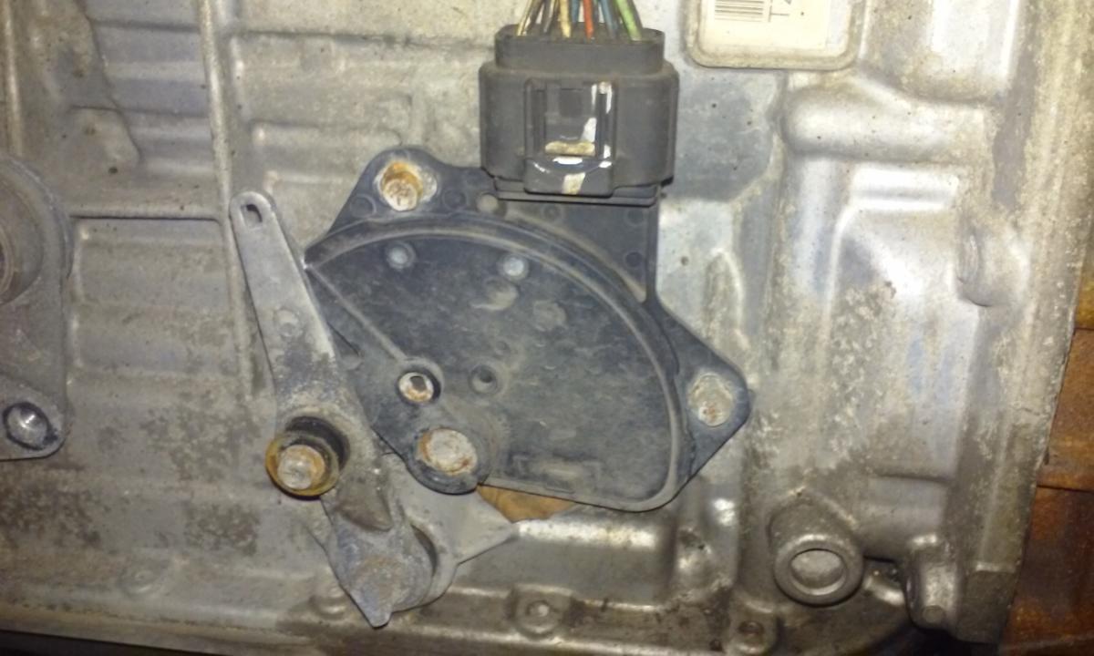

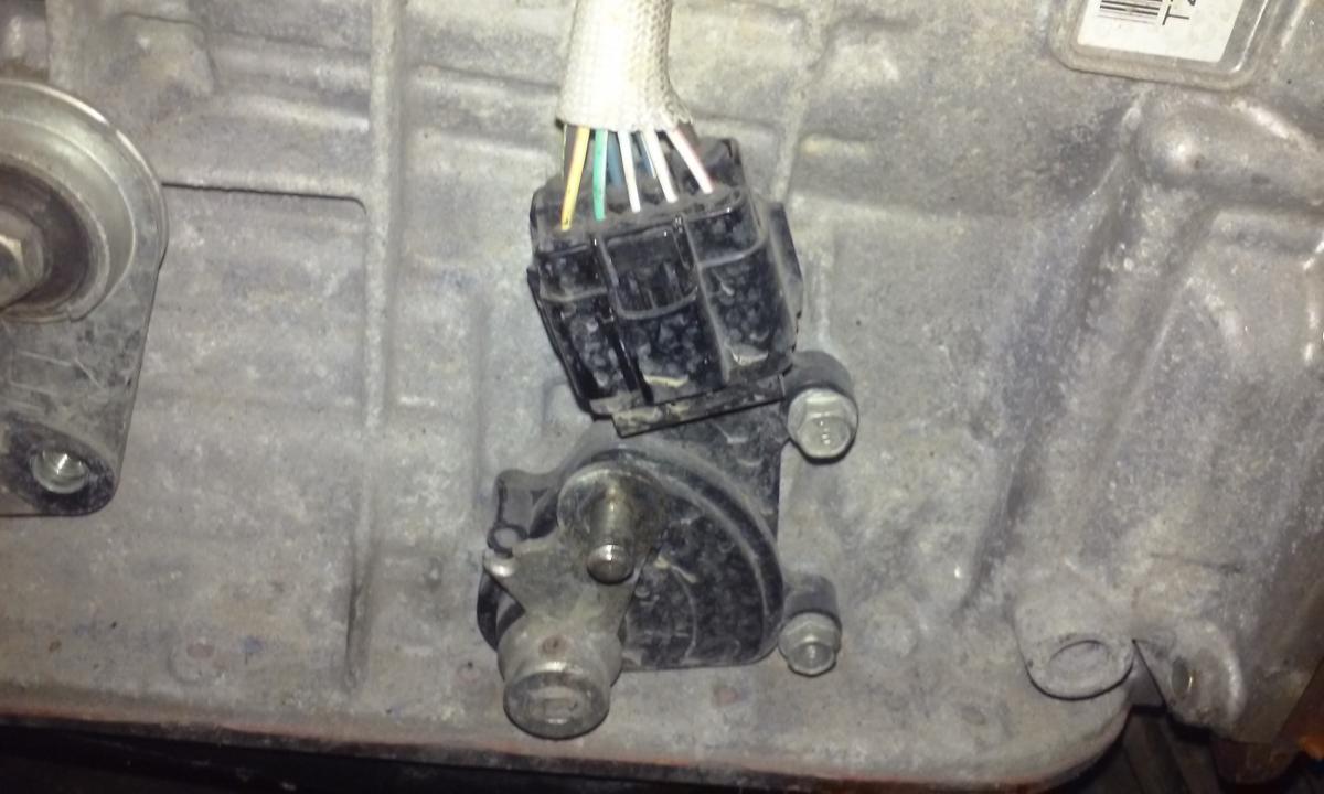

the shift selector switch is different as well. but has what looks like the same pigtail.
post-60906-0-54642300-1448925239_thumb.jpg is the 08 tailshaft sensor
post-60906-0-63903300-1448925323_thumb.jpg is the 08 select switch
post-60906-0-09993100-1448925422_thumb.jpg is the 09 switch

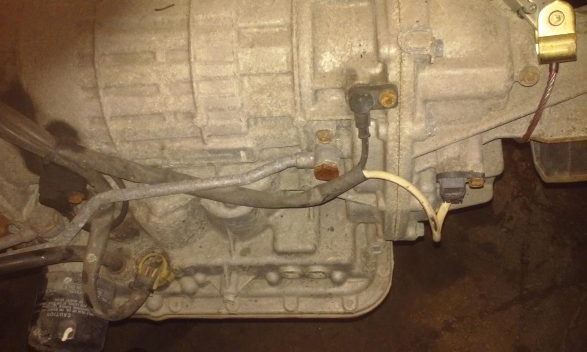

post-60906-0-41462700-1448925464_thumb.jpg is the 09 tailshaft housing with boss, without sensor.
