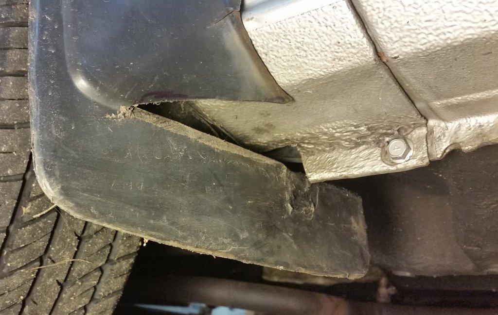

DaveT Posted December 28, 2015 Share Posted December 28, 2015 Here is one I recently came up with. The way the front fender and mud flaps come together at the bottom, just ahead of the doors, is a "self destruct by rust system". I modified the mud flaps by cutting off the rear part that traps dirt and moisture and holds it in contact with the bottom of the fender. I also used a piece of the cut off to weld into the hole that was made in the flap to clear the corner of the fender. So now, water and crud flying off of the tire won't get sprayed in to that [no longer existing] pocket, and the joint where several layers of steel that make the rocker panel and fender meet. I cut the fender to clear the mud flap, since there is no longer a hole in the flap. The other layers don't get in the way of the mud flap. The cut in the fender also should allow crud the gets into the space between the frame and the fender to fall out. I'm still thinking of opening that up more, but for now it is better than factory. Make sure that the thin plastic liner is layered correctly so the water is lead outside the fender, not inside. I used POR15 and Waxoyle to protect the various parts during re assembly. Replace all of the steel fasteners with stainless. Quote Link to comment Share on other sites More sharing options...
