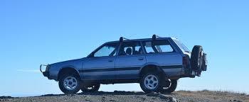

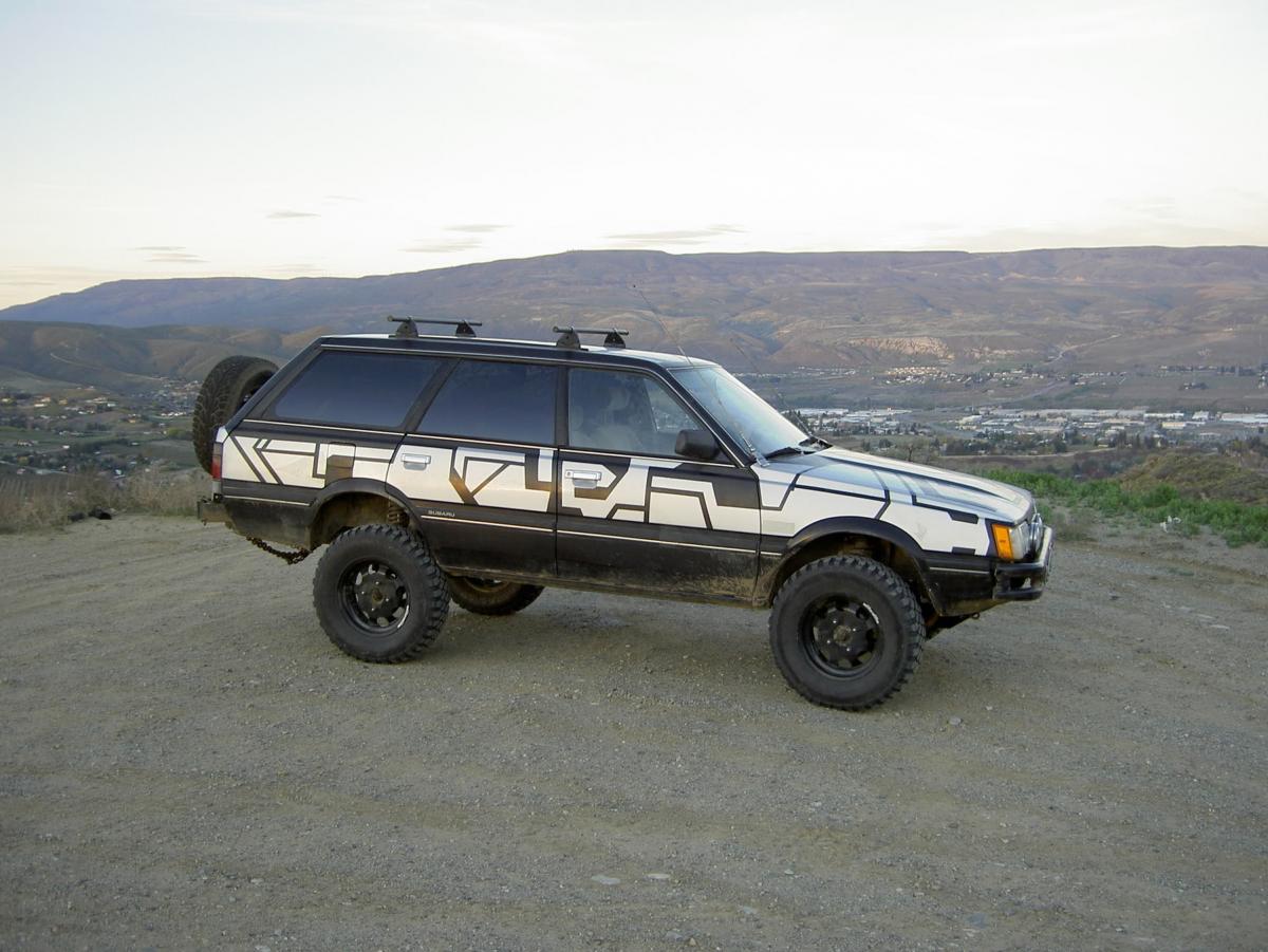

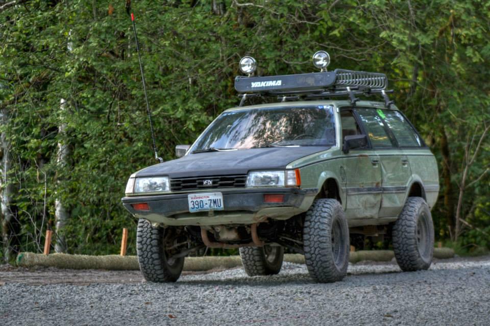

    i was told i might want to run an 8" lift to fit the transfer case.  its hard telling the diff lifts on somethese loyales.  here are some of the loyales that i think could be close to an 8 inch lift.  i'm just trying to get a better idea on how deep i'll have to dig into my pockets & the full scope of the project

3&5 are a 6" lift, 4 looks like a 4". IDK what's up with the last one, I think the just lifted the struts and dropped the diff, but is probably a 6" Tire seems real close to the rear wheel well. Here's an 8" .
IMO I wouldn't wanna go that high if you need to tow, might get a tad tippy. 4" would be my opinion for something that's gonna be towing and wheeling (or so I've heard, I'd ask some of the old timers).
