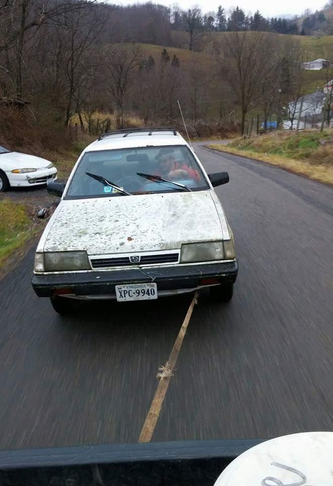

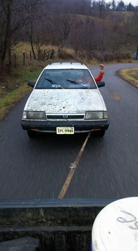

Just snagged a '93 Loyale..need advice
Just towed her home Wednesday! Got her for a load of wood! Score! Hahaha! It has been sitting for 4 yrs but turned over and ran for bout 3 sec. Think it sucked some gunk into the fuel filter or fuel pump. Going to do a tune up (oil, filters, try and get old gas out of the tank, spark plugs and wires,etc) what should I try and replace first beside the above before I try and turn it over again? I'm new to Subarus!
