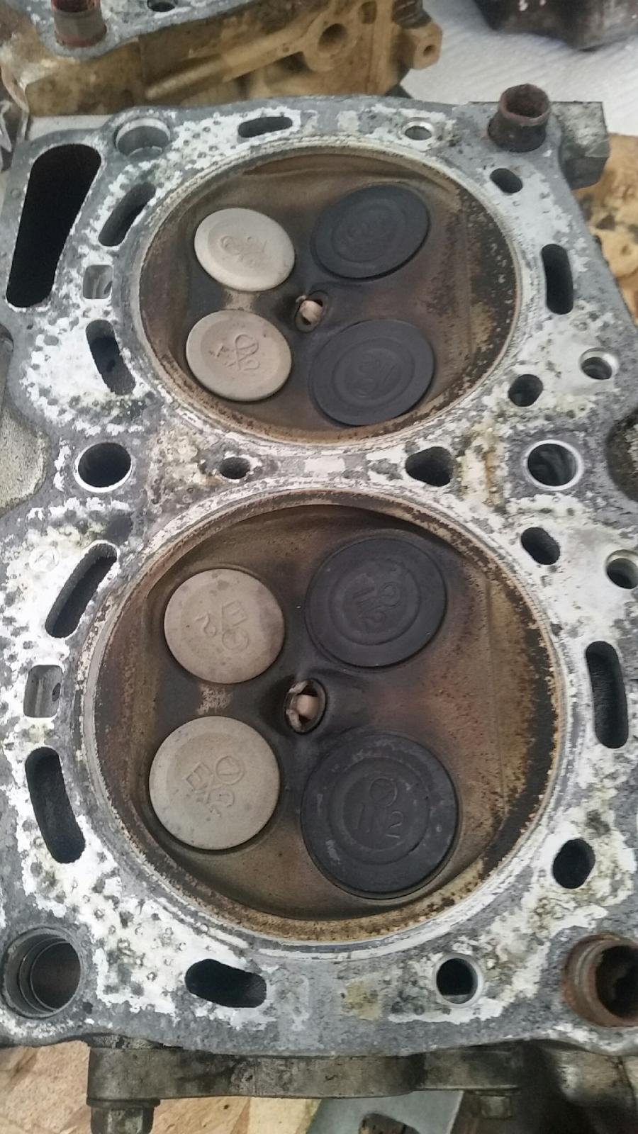

gravitate Posted February 11, 2016 Share Posted February 11, 2016 So It looks like my current engine has a rod knock so I am planning on doing a rebuild. I am rebuilding a ej22 from a 94 that got tboned with 135k on it. It used about 1 quart of oil every fill up. I took the heads off and the cylinder walls still clearly have cross hatch patterns in them so my guess is the motor didn't get broke in properly. So I plan on doing my first rebuild. I assume I just need rings and bearings and seals. I see a bunch of different prices online and I'm not sure whats considered good and what not. Does anyone have a recommendation? I'm on a budget so I'm not wanting any high end set. Also I'm wondering if anyone has a ball park on what it will cost to get the valves done along with valve stem seals and whatever work may need to be done to the crank plus my block will need a hot bath. I have the tools to hone the cylinders myself. Thanks Quote Link to comment Share on other sites More sharing options...

gravitate Posted February 13, 2016 Author Share Posted February 13, 2016 Well dang I just tried taking the heads off that 97 engine to put on my rebuild motor and 2 head bolts broke off in the motor. So much for using the head bolts or that motor again. Quote Link to comment Share on other sites More sharing options...
Fairtax4me Posted February 13, 2016 Share Posted February 13, 2016 Something was definitely wrong with that engine if the head bolts broke while trying to remove them. Seriously overheated, or someone had been in there before and installed cheap head bolts or way over torqued them. 1 Quote Link to comment Share on other sites More sharing options...
gravitate Posted February 13, 2016 Author Share Posted February 13, 2016 (edited) Yeah I feel like they must have been over torqued because they were a bitch even with a breaker bar. There was a lot of pressure behind them because everyone made a pssshhh sound and let off some horible smelling gass or something when I finally got them to break loose but I don't know maybe thats normal. But the heads look great. I was about to get a set of bolts online, are the cheaper ones really that bad? Edited February 13, 2016 by gravitate Quote Link to comment Share on other sites More sharing options...
Fairtax4me Posted February 13, 2016 Share Posted February 13, 2016 The cheaper ones are more prone to breaking. But I forgot, there is a way you can tell if the bolts are original (if they aren't too rusty) you should be able to see paint marks on the top of the bolt heads. Those are the inspection marks for the factory after they torque the bolts. If they were the original bolts and broke, I would definitely think someone has been in that engine before. The head bolts on these are pretty tight. A breaker bar is necessary to get them loose, but if they broke its because the threads seized the end of the bolt in the block. That could come from moisture getting in and causing it to rust. That's normally only a problem if the heads are very rusty though. If the bolt heads are clean I would think someone has had the head off before and galled the threads or overstretched the bolt. 1 Quote Link to comment Share on other sites More sharing options...
gravitate Posted February 13, 2016 Author Share Posted February 13, 2016 Well one head was stuck on for a day and after soaking it over night and beating it carefully over and over I finally got it off. Seems that the alignment sleeve got rusted and that got rusted to the bolt. Thats actually what happened on the other side too but unfortunately that broke off inside the motor. I'm wondering if the gasket leaked and allowed moisture up in there cause otherwise I'm not sure how water would get up in there. I found that I definitely have a bad bearing in that motor though so I'm just gonna trash it and put the heads on my rebuild. I'm really quite amazed at how easy it is to rebuild these things now that I've got one split. I'm actually enjoying the process. I just hope I didn't screw up the head somehow beating it so much. I beat on the corners where there is about a half inch of non mating surface. Quote Link to comment Share on other sites More sharing options...
