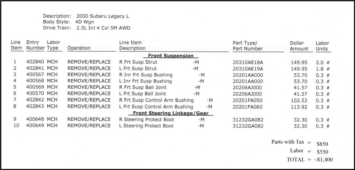

dirty_mech Posted April 16, 2016 Share Posted April 16, 2016 This thread is a continuation of a problem stemming from a front-end collision I previously wrote about here: http://www.ultimatesubaru.org/forum/topic/147562-replacing-the-camber-bolts-during-an-alignment-after-a-frontal-collision-necessary/?hl=%2Balignment+%2Baftermarket+%2BboltsSo it turns out you guys were right; my suspension parts are damaged. I learned this after a screw got stuck in the corner edge of one of my tires, causing a slow air leak. It was outside the area of the steel belts, which rendered it unrepairable. This also led to me noticing heavy tread wear on the inside track of my two front tires, even though they have only 10k miles on them. The previous alignment shop suggested I had a poor quality tire brand.This led me to replace the old tires with some high end ones. I described the issue to the tire shop, and explained the prior front end collision. The tire shop thought my previous tires were of reasonable quality, ans said that damaged suspension parts could be the culprit. So I took it to a shop and they found suspension parts which are likely bad, including the struts as previously mentioned by a poster. Here is the work estimate with parts they gave me:This car is worth about $3000, so a $1,400 repair job is too rich for my blood. So I am considering doing the job myself with aftermarket parts from Autozone and/or Parts Train:Both Struts ($325 from Subaru)Partstrain - $175 (Monroe OESpectrum)Autozone - $275 (Sachs or KYB) or $205 (Gabriel Ultra) or $105 (SenSen)2x Ball Joints:($90 from Subaru)PartsTrain - $65 (Moog) or $50 (Beck Arnley) or $20 ("Replacement" Brand)Autozone - $45 (Valucraft)2x Inner Transverse Link Bushings ($115 from Subaru)PartsTrain - $45 (OES Genuine)2x TLBs with Mounting Brackets ($235 from Subaru)Partstrain - $110 (Whiteline)Steering Rack Boots ($80 from Subaru)Partstrain - $20 (Mevotech) or $45 (AC Delco)My three (3) questions are these:1) Is there any particular part I should definitely get OEM from Subaru, or may I proceed with all aftermarket parts? Brand or merchant suggestions are appreciated.2) Is there any reason I should not attempt to replace these parts myself? I see the repair manual indicates I will need two special tools: a. A strut spring compressor. I plan to use Autozone tool # 27036 for this. b. A two-jaw puller and/or pickle fork for the ball joint. I have both these tools. 3) Do I need to have my alignment re-done after the new parts are installed?The mechanic checked my car up in the air with a broomstick-sized caliper, apparently checking the squareness of the suspension parts at certain points across the chassis and at the control arms. Perhaps this was to test part of the suspension's alignment. So it seems like I might need to have the alignment re-done by a shop if new suspension parts are installed. Quote Link to comment Share on other sites More sharing options...

Rooster2 Posted April 16, 2016 Share Posted April 16, 2016 I suspect what you need most to fix your bent suspension is replacing the struts and control arms. I would not recommend SenSen struts. I looked into buying them, and opinions on the internet were not good. There were complaints that they did not last long, and over all quality is questionable. Also, would not recommend Valucraft products from Autozone. IMO, your ball joints may not be damaged. Check for "play" at the joint. If no "play," then I would question that they need to be replaced. The steering rack boots have nothing to do with bent suspension problems. However, the boots may be torn, but they can be replaced at another time. I agree with others regarding buying from Rock Auto. There prices and delivery are good. Also agree, that good parts can be obtained at a U pull wrecking yards for cheap, if you have the time. The yards offer the learning benefit of being able to remove the parts you need, so that when you work on your car, you will know exactly what to do. Utube videos are a good learning tool to use. Yes, you will need to get another front end alignment upon replacing the suspension parts. Quote Link to comment Share on other sites More sharing options...

uniberp Posted April 18, 2016 Share Posted April 18, 2016 This thread is a continuation of a problem stemming from a front-end collision I previously wrote about here: http://www.ultimatesubaru.org/forum/topic/147562-replacing-the-camber-bolts-during-an-alignment-after-a-frontal-collision-necessary/?hl=%2Balignment+%2Baftermarket+%2Bbolts So it turns out you guys were right; my suspension parts are damaged. I learned this after a screw got stuck in the corner edge of one of my tires, causing a slow air leak. It was outside the area of the steel belts, which rendered it unrepairable. This also led to me noticing heavy tread wear on the inside track of my two front tires, even though they have only 10k miles on them. The previous alignment shop suggested I had a poor quality tire brand. This led me to replace the old tires with some high end ones. I described the issue to the tire shop, and explained the prior front end collision. The tire shop thought my previous tires were of reasonable quality, ans said that damaged suspension parts could be the culprit. So I took it to a shop and they found suspension parts which are likely bad, including the struts as previously mentioned by a poster. Here is the work estimate with parts they gave me: img032.jpg This car is worth about $3000, so a $1,400 repair job is too rich for my blood. So I am considering doing the job myself with aftermarket parts from Autozone and/or Parts Train: Both Struts ($325 from Subaru) Partstrain - $175 (Monroe OESpectrum) Autozone - $275 (Sachs or KYB) or $205 (Gabriel Ultra) or $105 (SenSen) 2x Ball Joints:($90 from Subaru) PartsTrain - $65 (Moog) or $50 (Beck Arnley) or $20 ("Replacement" Brand) Autozone - $45 (Valucraft) 2x Inner Transverse Link Bushings ($115 from Subaru) PartsTrain - $45 (OES Genuine) 2x TLBs with Mounting Brackets ($235 from Subaru) Partstrain - $110 (Whiteline) Steering Rack Boots ($80 from Subaru) Partstrain - $20 (Mevotech) or $45 (AC Delco) My three (3) questions are these: 1) Is there any particular part I should definitely get OEM from Subaru, or may I proceed with all aftermarket parts? Brand or merchant suggestions are appreciated. 2) Is there any reason I should not attempt to replace these parts myself? I see the repair manual indicates I will need two special tools: a. A strut spring compressor. I plan to use Autozone tool # 27036 for this. b. A two-jaw puller and/or pickle fork for the ball joint. I have both these tools. 3) Do I need to have my alignment re-done after the new parts are installed? The mechanic checked my car up in the air with a broomstick-sized caliper, apparently checking the squareness of the suspension parts at certain points across the chassis and at the control arms. Perhaps this was to test part of the suspension's alignment. So it seems like I might need to have the alignment re-done by a shop if new suspension parts are installed. The parts listed all seem to be wear/age parts, so I question that they will correct any damage. If they did the collision repair to makes the car drive straight down the road, it might be at the expense of the tires. I would suggest you get sa full alignment measurement (camber, caster and toe-in) and see how far those are off from spec. Then you might know how much actual damage was done to the unibody or suspension mounts, before you throw parts at it. If the frame or suspension mounts are tweaked, it's doubtful that parts will correct the tire wear issue. Control arms are stamped steel, can be bent and are available aftermarket. Quote Link to comment Share on other sites More sharing options...
