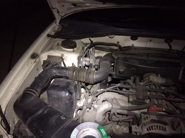

lostinthe202 Posted April 26, 2016 Share Posted April 26, 2016 (edited) Hi everybody! I'm just finishing up replacing the manual trans in my legacy and I've got this hose barb on the airbox that is looking pretty lonely. I can't find the mate for it anywhere. This was at the end of the day, so my next step is to pull the air box and look for it, but it would help if I knew where the other end went. Anyone recognize it? Thanks! http://s141.photobucket.com/user/driftingouttosea/media/Air%20Box%20Outlet_zpsicsp7h4g.jpg.html" Edited April 26, 2016 by lostinthe202 Quote Link to comment Share on other sites More sharing options...

wtdash Posted April 26, 2016 Share Posted April 26, 2016 (edited) +1 for the PCV -should be a another port on the PCV 'T' connector from the block to the IM that goes there. Like this post? And if that pic was about 2 feet farther back.....we could see the PCV. What year? Edited April 26, 2016 by wtdash 1 Quote Link to comment Share on other sites More sharing options...

wtdash Posted April 26, 2016 Share Posted April 26, 2016 (edited) Hmmmm, see attached from my step-son's '00 OB. Can't tell where it goes, but doesn't look to link into the PCV, as you can see the PCV and it appears to just go from block>>TB. I can't get to opposedforces.com @ work...but it 'should' show it, too. Edited April 26, 2016 by wtdash Quote Link to comment Share on other sites More sharing options...
lostinthe202 Posted April 26, 2016 Author Share Posted April 26, 2016 Yeah, thanks for the pic, that's basically what I thought I remembered it looking like. I must have it buried somewhere 'cause I know I didn't take it off the car, no reason to. I just can't find the blasted thing. I figured if I knew where the other end was supposed to be, I could try and find it by looking for the source. I tried Oppossed forces and there is one pic that indicates that it's a hose on the intake manifold on the passenger's side and that they're all tied to the PCV. I won't get to the car until tomorrow AM unfortunately. Here's the pic Quote Link to comment Share on other sites More sharing options...
Fairtax4me Posted April 27, 2016 Share Posted April 27, 2016 Breather hose from the right side valve cover. 1 Quote Link to comment Share on other sites More sharing options...
Legback0203 Posted April 27, 2016 Share Posted April 27, 2016 I'm with fairtax. I've had 4 of these so I'm pretty sure. It should have that pcv hose though. They eliminated the T that goes to the airbox in 02. Just goes straight to the intake after that. Yours being a 2000 should have the T set up though. Quote Link to comment Share on other sites More sharing options...
lostinthe202 Posted April 29, 2016 Author Share Posted April 29, 2016 Found it. It was hiding amongst the power steering hoses. It's about the same diameter and was nestled in with them such that I couldn't see the end. There's my idiot move of the week out of the way, thanks all!! Quote Link to comment Share on other sites More sharing options...
