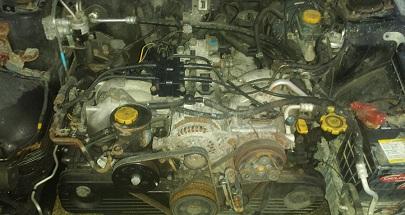

I have a automatic 99 subaru legacy and last year the timing belt pulley broke. I found a motor to put in it which I got from a 5 speed wrx It is a ej25 motor, when I got the wrx it started up with no problem. We put the wrx motor into my subaru...and nothing..It was turning over but would not spark...Since it came from a 5 speed we unplugged the cam sensor, still nothing. We put a brand new coil pack in, still nothing. It wasn't getting fuel until we replaced the timing relay plug. It gets fuel now...but still no spark. I have talked to countless mechanics and no one knows for sure what it is, some tells me it is the computer but others tell me it isn't. Any idea what could be causing this?

I think all WRXs have had turbo motors from day one of US introduction. Like you say, someone may have installed a non turbo in the 02 WRX. Posting some motor pixs to us on the forum may help identify what motor you have. There will also be some motor ID stamped into the top of the block to help identify the motor. Helping us with more info, is the best way for us to be able to help you.
