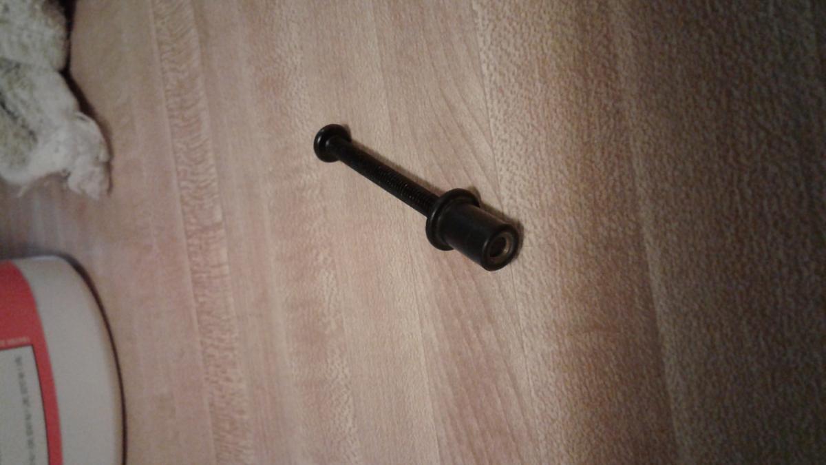

superooo Posted June 6, 2016 Share Posted June 6, 2016 I use these for mounting hardware, theyre rubber, put a dab of silicone to hold it and add waterproofing, but the rubber crushes to seal the hole, 36/c ea at ace. Any time you drill your exterior its best to scuff and prime the hole, even if its parts store primer, these cars already rust like a Scottish fishing boat, so if you dont want to eventually sweep it out of your garage, do all the preventative work youcan lol. Just my 2c Quote Link to comment Share on other sites More sharing options...
