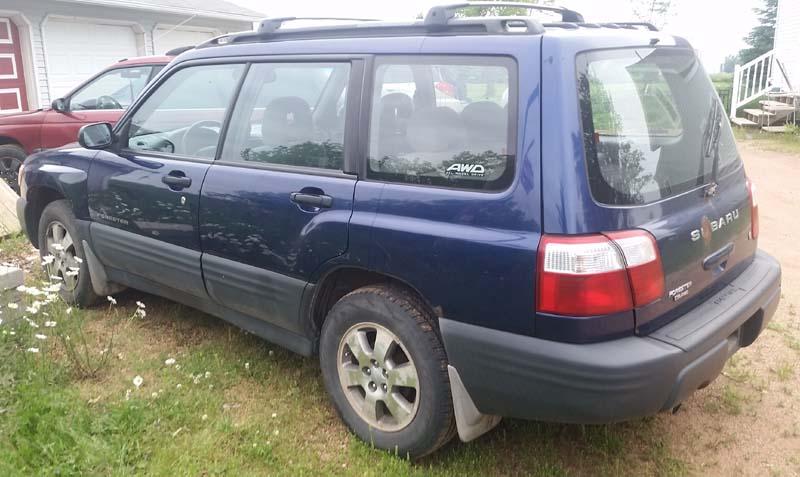

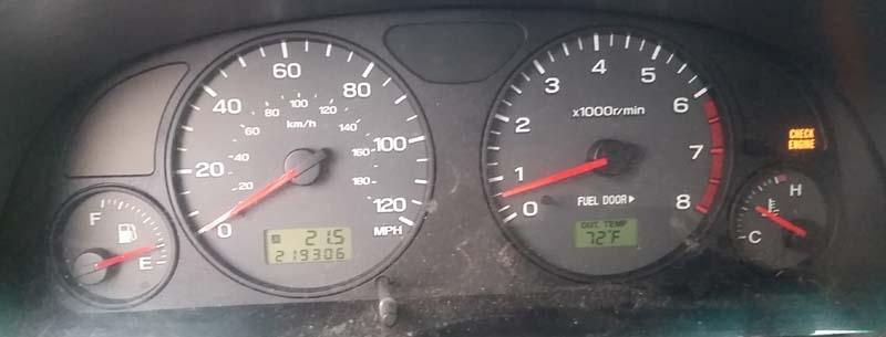

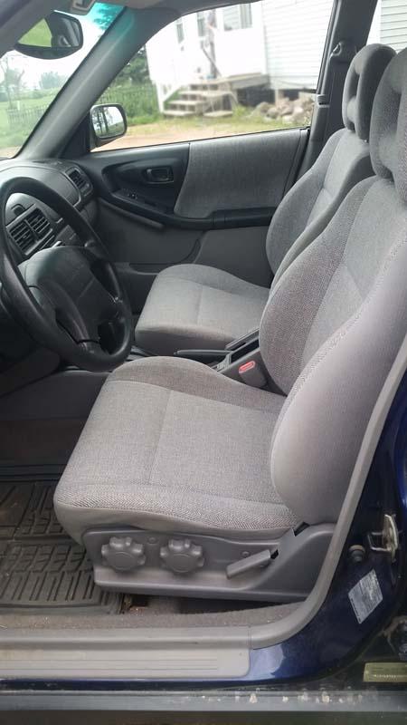

heartless Posted June 14, 2016 Share Posted June 14, 2016 Just picked up a 2002 Forester L with the EJ251, auto, in good condition for it's age and location. The interior is nearly showroom perfect, belying the 219,200 miles on the odometer (guessing mostly highway miles). It runs and drives nicely, temp was rock steady for the short test drive (nearly out of gas, so we didn't go far), & tranny shifted fine. So, educate me (us) on the pros & cons of this little beast. things to look out for? is this one prone to head gasket issues? if so, how do they manifest? worst case scenario, how much of a pain would it be to swap in a 95 EJ22? our plan before it becomes a daily driver will be a timing belt job, and addressing the rear hatch not latching. Quote Link to comment Share on other sites More sharing options...
Fairtax4me Posted June 14, 2016 Share Posted June 14, 2016 External head gasket leaks. At 219k its likely had them replaced already, which means you shouldn't have any problems with them again. No easy way to put a pre-99 engine in there. Once you break that 99 barrier the non-interference bullet proof 2.2 is out the window. If you know an electrical engineer who can fool the idle control system and re-work the ignition control wiring it could probably be done, but its not gonna be an easy drop in. Quote Link to comment Share on other sites More sharing options...

heartless Posted June 15, 2016 Author Share Posted June 15, 2016 took the code reader with us when we went to pick it up - had several active and pending codes, but for some reason the reader was having difficulty maintaining a connection with the car (it is an Actron reader and works great on both my 1995 and the other half's 2006, so not sure why it was acting up with the 2002 will investigate that more later) 1st code listed was knock sensor, O2 was in there as well (both active and pending - different banks maybe? - again, will investigate more later) Codes aside, the car runs great, drove it the 20 miles home with no issues. Coolant temp was rock steady the whole way, and fans function as they should (kicked on when I parked and let it idle for a few minutes) wtdash - yeah, I am aware of the fuel filler neck issues, and have some concern on this one - the part visible in the fuel door area doesn't look pretty, in spite of the good condition of the rest of the car. Anyway, on to pictures of the new ride... Quote Link to comment Share on other sites More sharing options...
