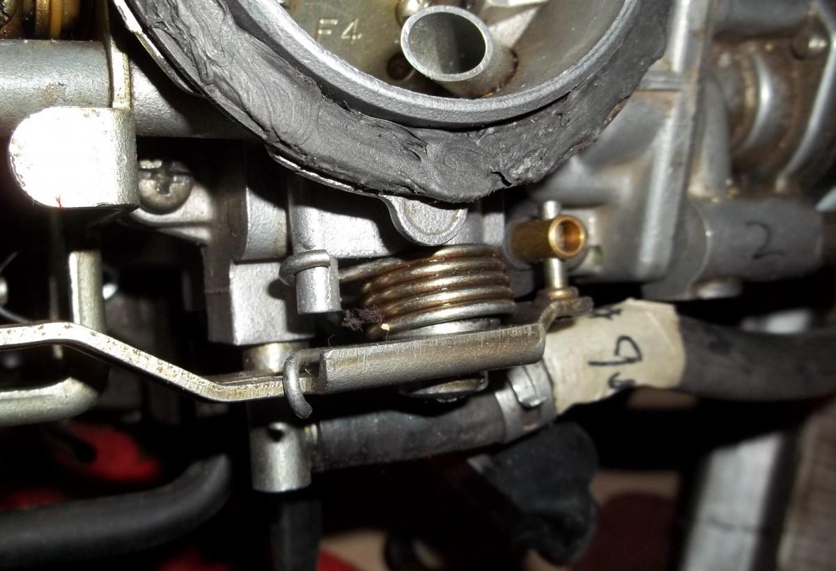

mete3 Posted July 1, 2016 Share Posted July 1, 2016 I accidentally posted this in the historic forum so here is the question again. This question is about the carb on an 86 4wd Brat: Do I need the spring that attached to the accel pump lever/shaft? If so how does it attach? I cannot seem to figure it out and most pictures I have seen seem to not have the spring anymore. If you have a pic it would really help me! Thanks! Quote Link to comment Share on other sites More sharing options...
wallaby Posted July 1, 2016 Share Posted July 1, 2016 do you mean the spiral type spring that goes behind the screw in the top? or the return spring that hooks on the side of the carb? i will try to get a pic of one of mine so you can point and grunt.... Quote Link to comment Share on other sites More sharing options...
mete3 Posted July 1, 2016 Author Share Posted July 1, 2016 The spiral type that goes behind the screw in the top. I cannot seem to get it in there right. Quote Link to comment Share on other sites More sharing options...
Sapper 157 Posted July 5, 2016 Share Posted July 5, 2016 Okay here is a pic of the spring... the longer end hooks to the accelerator pump arm, and the shorter end hooks to the little tube you see there 1 Quote Link to comment Share on other sites More sharing options...
