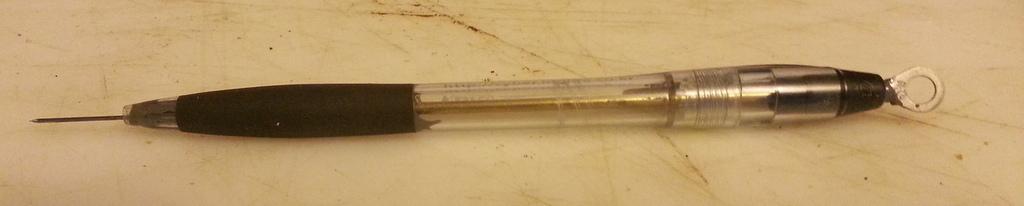

rwoerz Posted July 13, 2016 Author Share Posted July 13, 2016 That's the direction in leaning. I made a tool out of a pen yesterday that should help gaining access to the wiring. Quote Link to comment Share on other sites More sharing options...
