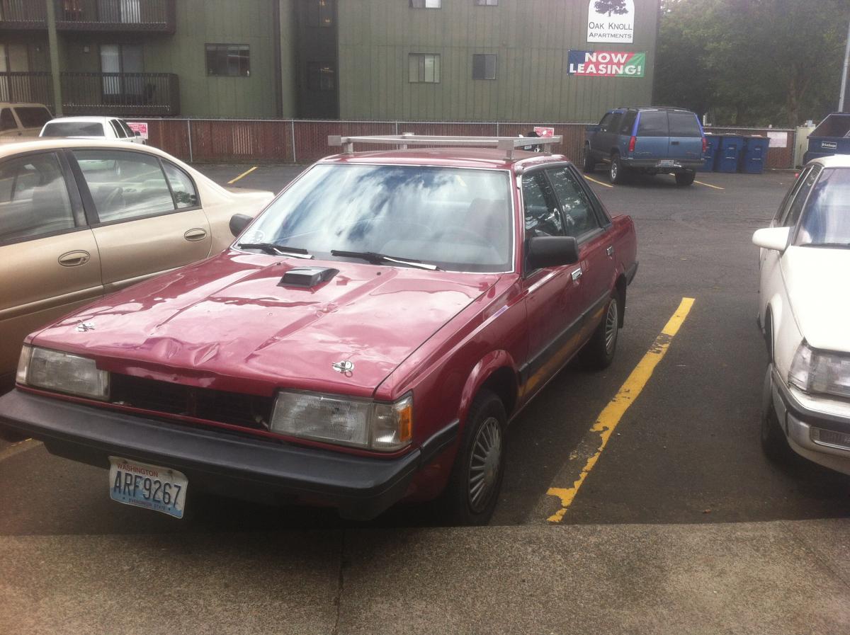

Crazyeights Posted August 9, 2016 Share Posted August 9, 2016 Here is my '92 Loyale with the EJ22 and EJ 5MT conversion done. It also has the 5 lug swap done with 16's in this picture. 1 Quote Link to comment Share on other sites More sharing options...
LittleLoyaleMan Posted August 9, 2016 Author Share Posted August 9, 2016 Crazyeights your Loyale is beautiful, the paint is amazing. Love the rims. As I've said before, in my area there aren't many old gens in good condition out here, and even less Loyale Sedans. So I hope by doing this, not only will my car stand out more amongst the sea of Soobie's in Vancouver, but also have power to show with it. But with every great project there has to be a start. I'm gonna save a bit more money so I can get a decent donor car (thinking a 95 legacy) and in the meantime do as much research on this process. Once the project is moving forward more, I'll be sure to post pics and update anybody who's interested in the progress 1 Quote Link to comment Share on other sites More sharing options...
MR_Loyale Posted August 10, 2016 Share Posted August 10, 2016 Here is my '92 Loyale with the EJ22 and EJ 5MT conversion done. It also has the 5 lug swap done with 16's in this picture. Where did you get the chrome wheel arch trim? Quote Link to comment Share on other sites More sharing options...
Crazyeights Posted August 10, 2016 Share Posted August 10, 2016 The wheel arch trim was already there when I bought it. Quote Link to comment Share on other sites More sharing options...
