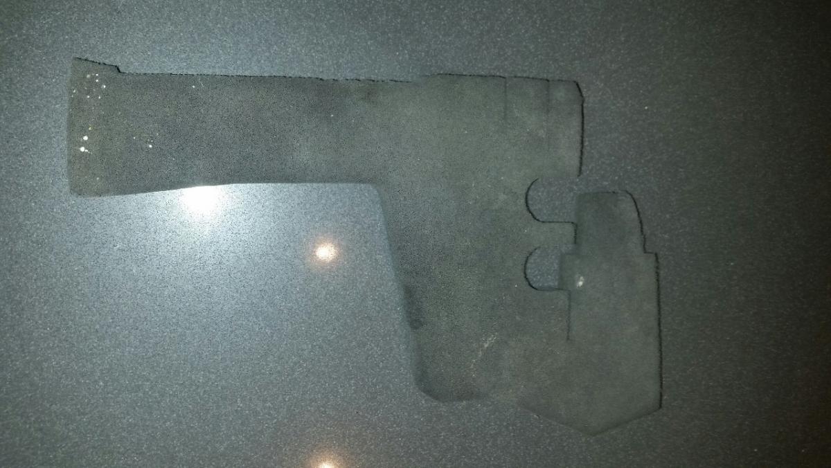

Hello everyone,
I replaced my clutch a few months ago and all is well, except for a rattle emanating from the front right corner of the vehicle (sounds like it is just inside the wheel well, like unfastened metal lines vibrating against the inside wall of the engine compartment).  This only happens at low idle. Not coincidentally, the only piece that I could not find a spot for, was a strategically shaped piece of foam (as seen in the attached pic). It feel out of the bottom of the car when I removed the plastic protective covering to better access the transmission.
Thanks
Jon

Sometimes chunks of foam are glued to the plastic splash shields to keep them from vibrating in the wind and making noise when you're driving. They fall off occasionally. That won't likely cause the other noise you have.
Sounds like the heat sheild on the exhaust pipe may be loose. They get loose on their own anyway, but especially if you've had the exhaust down off of the car they get knocked around and rattle pretty bad.

Sorry about the link! I posted a new pic!!
