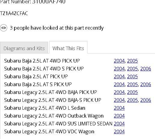

Thanks for your help. I dubble checked transmission code and it is the tz1a4zcfac in the 99 forester. I recentally aquired this car so I don't know the history but could this be a different transmission that was put in. I noticed yellow pen markings on it like from a parts yard. If I'm replacing this transmission should I get the same tz1a4zcfac that's in it now I'm sure it was compadable with the diff ratio because the previous owner was driving it.
Hi,
No offense, but driving it doesn't mean it's correct. The FD ratio is probably fine - 4.44 but the trans computer may not know what to do with it. Is the AT Temp light flashing on startup? You could see if the TCU/TCM (trans computer) from the list above will plug in to yours (doubt it though).
Go to Car-part.com and search on year/make/model - search ALL to find p/n.....search local for pricing. I found this trans code: TZ1A3ZC2AA
When I Google that P/N:
 What This Fits
Subaru Forester 2.5L AT L    1999, 2000, 2001
Subaru Forester 2.5L AT S    1999, 2000, 2001
That's the wrong trans in your car.....probably why it failed.....speaking of which, What's it doing?

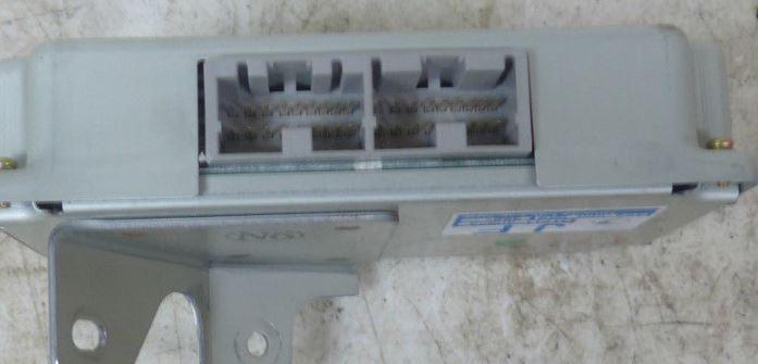

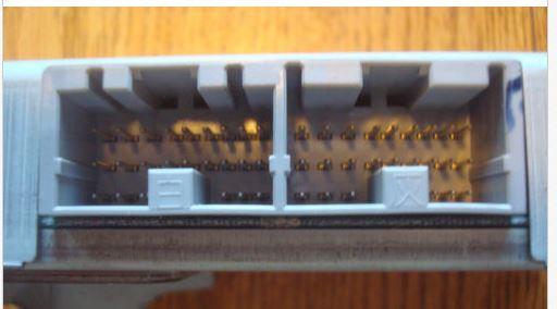

Attached are pics of the TCU's for your '99 and a 2004 Legacy....it LOOKS like they should interchange, but that doesn't mean it'll work, as the transmission you have installed may have the VDC/VTD and the wiring for the sensors aren't likely in your wiring harness from the transmission to the TCU....since yours is 5 years older. If you have a USED parts yard nearby that allows returns you could try it.
So, Yes, the best route is to just find a compatible transmission. Although 11K miles looks good on paper, it's important to see how long it's been sitting on their shelf. The internal seals will harden up if not in use and they probably won't warranty the seals if the trans leaks after being installed. I can't say how long is TOO long, but I'd be cautious if over a year sitting on the shelf. The parts place should have the VIN from the car it came out of and you get a VIN check for $1.50 here - http://www.freecheapvin.myspan.in/ - to see if the #'s and dates match what they're telling you.
