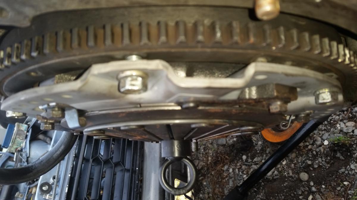

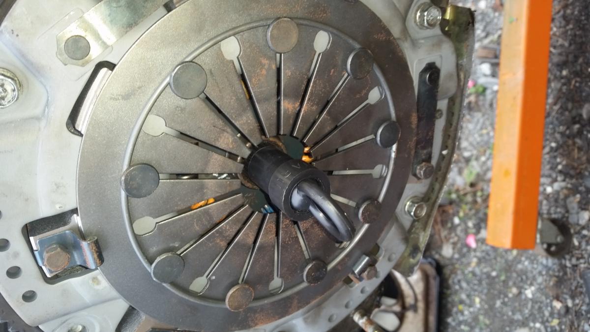

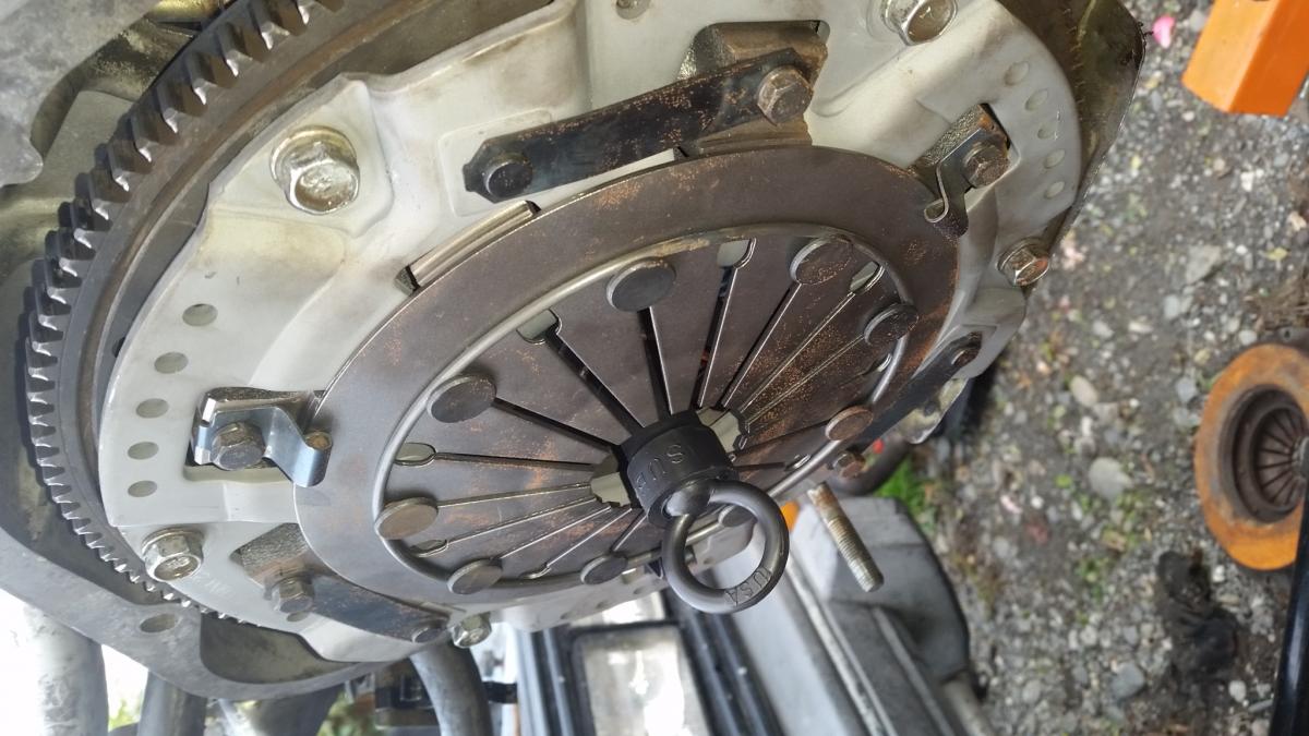

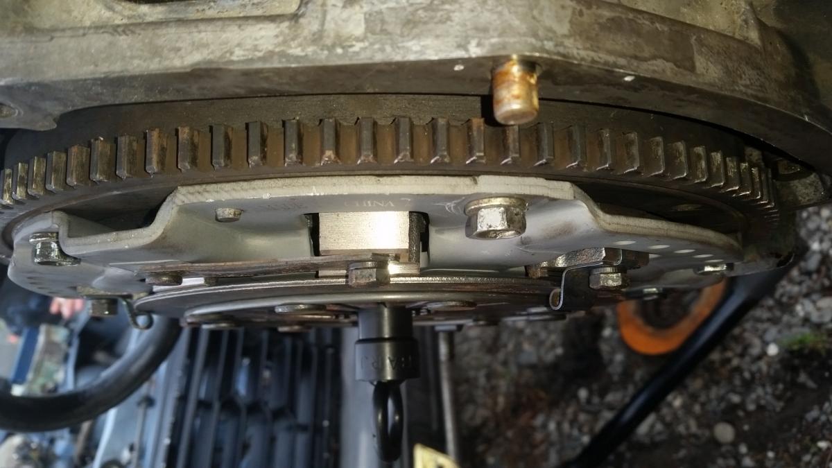

Sounds like the flywheel was not machined correctly. These cars have a stepped flywheel, so the pressure plate mounting surface must have the same ammount of material removed as the disc mating surface. are you sure there isn't some other install issue like clutch cable adjustment or throw-out bearing or fork not seated correctly?
Alignment pins holding it up? Does the 1/8 gap between the cover and the flywheel disappear when you torque the bolts down (cover mounting flat and flush)? Its under spring pressure so there will be resisntance as you tighten it up. Thats how the clutch is engaged.
ISo the disc is tight and release fingers compressed due to proper contact or sandwiching? From what you are describing it sounds like the issue may lie else where in the system. Whats the play like when you jiggle the fork? You should be able to feel when the fork/TOB assy touches the release components but not tight or stuck. If that feels good, Ide hook up the cable and work the clutch. This may aide in your diagnostics, Im assuming the engine is bolted to the trans and mounts at least resting on the frame.
Alright if i did this right first two pics should show clutch cover with bolts loose no tension
And these two should show it bolted down and the fingers flat
Thoughts?
