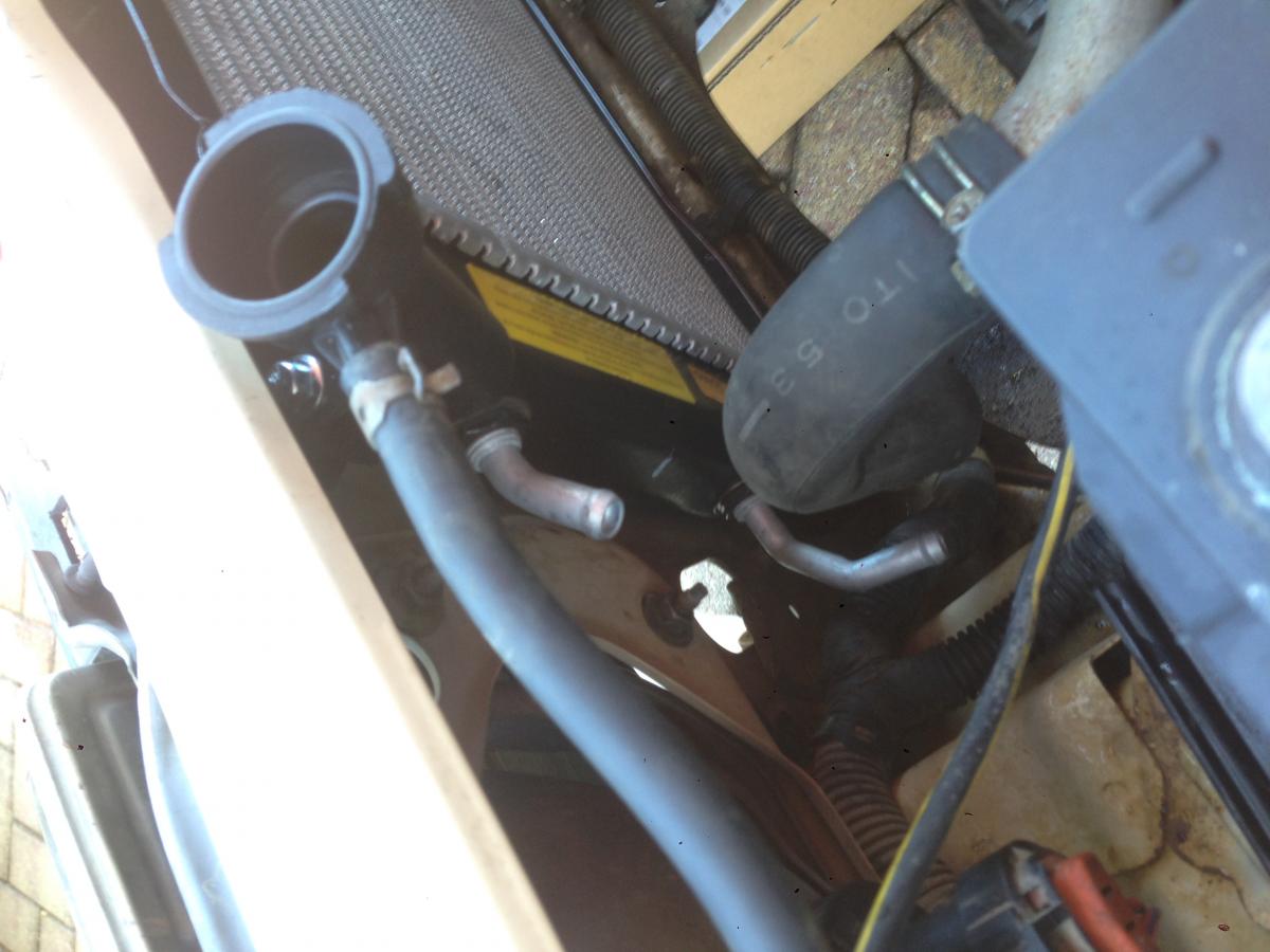

Quick question during a radiator install. I assume they are ports for the transmission or something.
These two shiny silver ports have no home on my car, should I cap them? If so, what's the best way to go about it? Remove them and screw in a plug or just plug them with the silver pipe connected?
I'm driving an ea82 non turbo 5sp dr wagon, weberized, no ac and manual steering.
Yep, aftermarket companies don't bother making a separate part without the trans cooler. They usually come capped. It's a sealed cooler, so it doesn't "need" to be capped, but it's certainly a good idea to keep crap out of there. Lots of ways to get caps, Dorman makes a multi-pack of different sized caps that can usually be had in the "Help" section of most auto parts stores for a few bucks.
