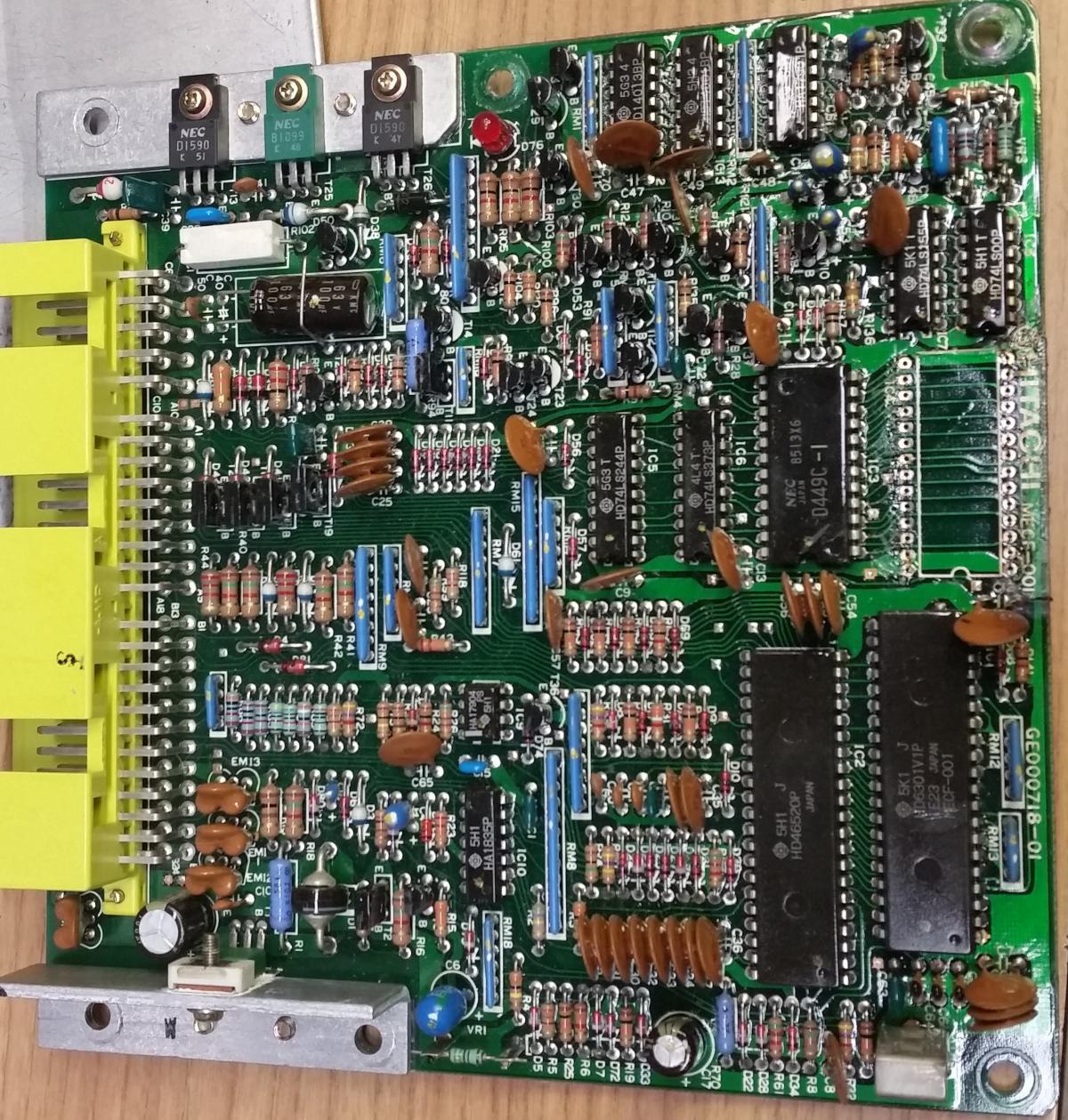

I don't see any connections on the ECU other than the external harness connectors, no secret ports.
I can also read & burn & erase these EPROMS.  When it gets far enough, I'll buy some.
I'll install a socket in this ECU for the EPROM.
I'll post pictures of the PCB tomorrow.  [technically later today]

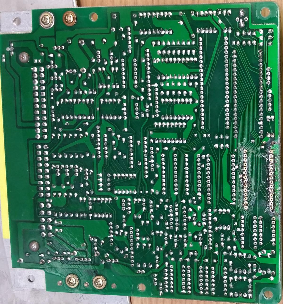

I can trace out where at least some of the external sensor pins are wired, I have generated schematics from a number of circuit boards.
The Big IC next to the CPU - I would not be surprised if it was a A to D / D to A converter or Analog I/O of some sort.  There needs to be one, and there are a lot of analog circuity near it.
The PCB looks like its only 2 layer.

P20 = pin 8
P21 = pin 9
P22 = pin 10
All 3 are tied high by 1.00K resistors.
Pin 7 [standby NOT] is wired directly to +5V
That would mean mode 7 (single chip mode). That doesn't make sense looking at the memory map for mode 7. That indicates NO external memory. We know we have an EPROM. What am I missing here?

Depending on which data sheet I look at, I see also that pins 4 & 5 may select modes.  The smaller data sheet I posted the part number matches 100%.  The big one covers many more ? or slightly different? ones.
I just rechecked the 3 pins, 8,9,10 and yes, they are tied high by 1.00K resistors.
4 & 5 measure 4-6K  to either VCC or GND, so I'll have todo some sort of powered up test to determine them.

Some address and data lines:
EPROM      CPU
D0  11          37
D1  12          36
D2  13          35
D3  15          34
D4  16          33
D5  17          32
D6  18          31
D7  19          30
EPROM      CPU
 A11  23       26
A10   21       27
A9     24       28
A8     25       29
I'm thinking these are high byte memory address lines.
A0 of the EPROM goes to pin 9 of the LS373 8bit latch  It's the Q4 output.  I haven't found where the D4 input is.  The damn conformal coating makes tracing by ohmmeter difficult.  I may just start removing more ICs.
