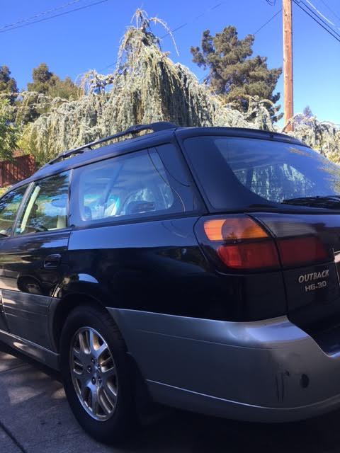

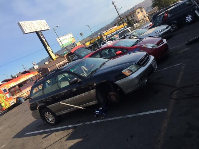

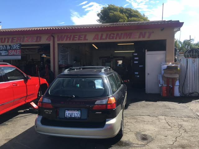

gretzky_91 Posted January 18, 2017 Share Posted January 18, 2017 Hello everyone , I'm glad to join the group! In September of 2016 I purchased a 2002 Subaru Outback LL Bean Edition with 262,xxx for 8 bones . The truck needed a power steering pump and hadn't cleared smog here in California with hideous tires. I replaced the power steering pump and was able to clear inspection. In December the truck threw a P0340 and P0420 symptoms included sluggish acceleration , rough idling at stops and even stalled more times than id like to rember but never had to call a tow. I put my scanner on and found the Cam Sensor would be my next bet. I installed the cam sensor 2 weeks ago and cleared the light. I've felt better response but yesterday on my way to work the P0402 came back up any advice on how i can fix this to make sure the subie is good to go to Tahoe this weekend. Best Regards , Ruben Quote Link to comment Share on other sites More sharing options...
