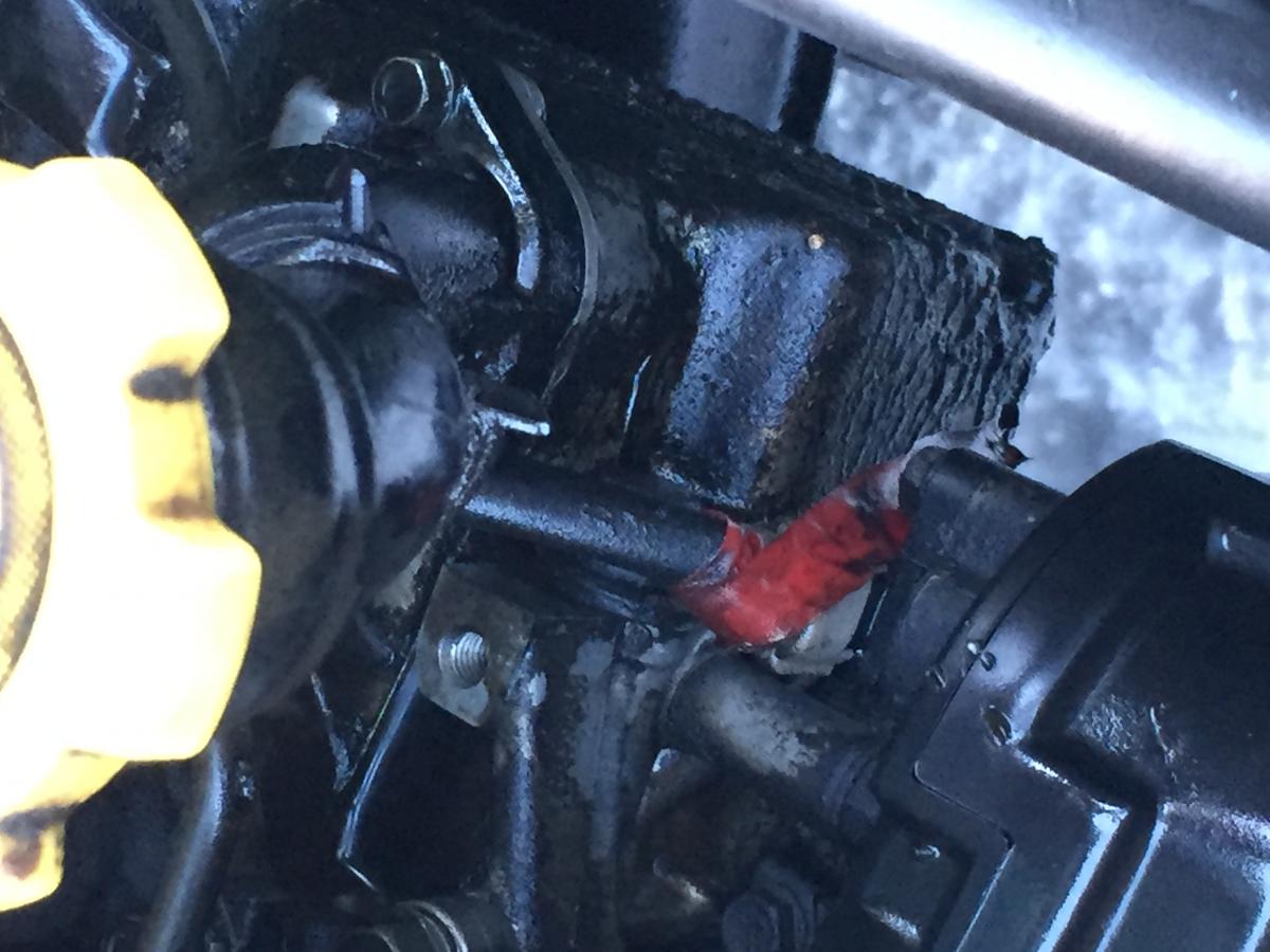

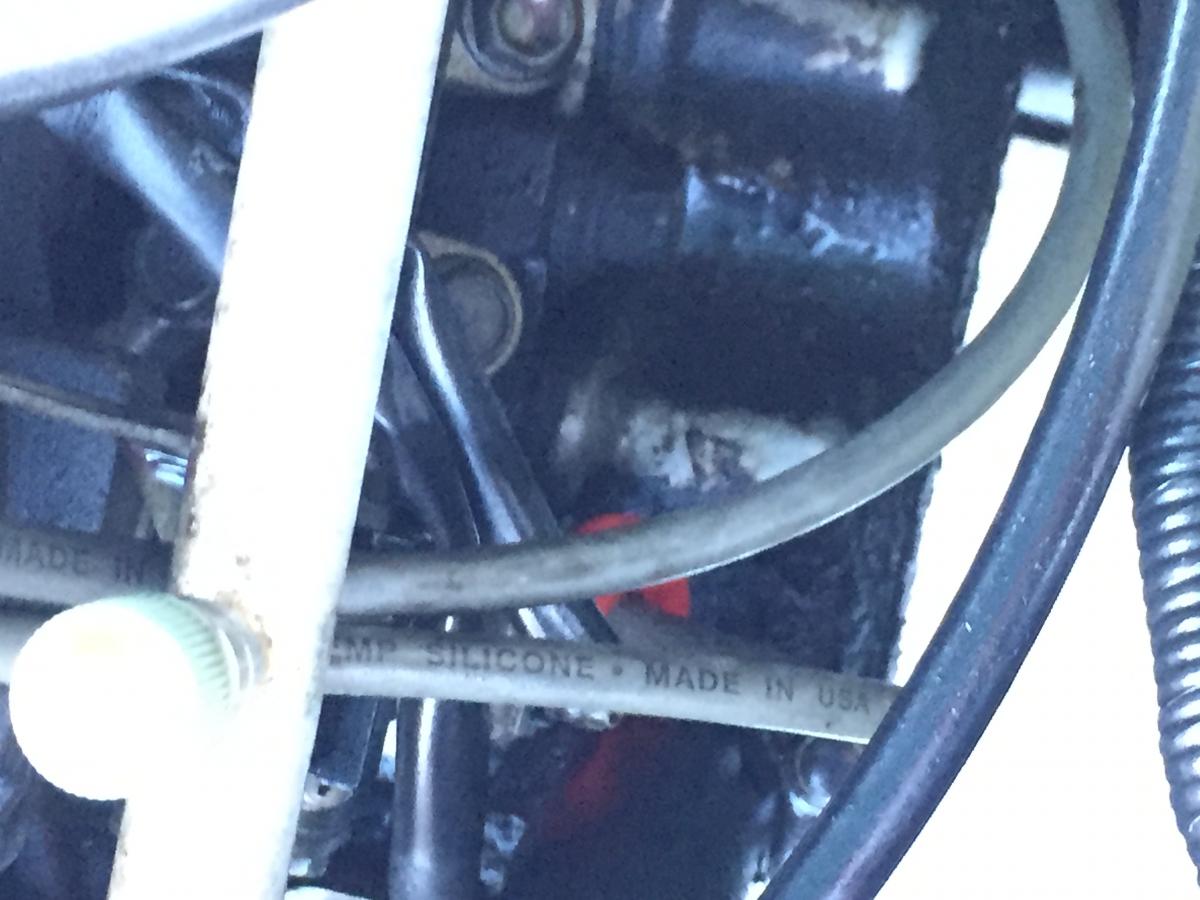

Hard to tell from picks. It's leaking on top under the engine hood?
Did you check underneath?
Normally they leak from valve covers or cam seal. Both from the bottom of the engine, valve covers from valve covers will be dripping, cam seal will show oil dripping from behind black plastic timing cover on front of engine.
If yours is leaking on top - then replace PCV valve and any clogged PCV hoses.
Pictures and words are hard to work with but your leak may be underneath and not shown in the pictures. The oil signs in those pictures appear old, caked on debris built up over a long time, not dripping and pooling wet like I'd expect if you had a "trail of oil in the snow".
Look more closely underneath.
Find the wet dripping and follow its trail up and forward from there. (Forward since motion of car generally pushes oil leak back from the source)
