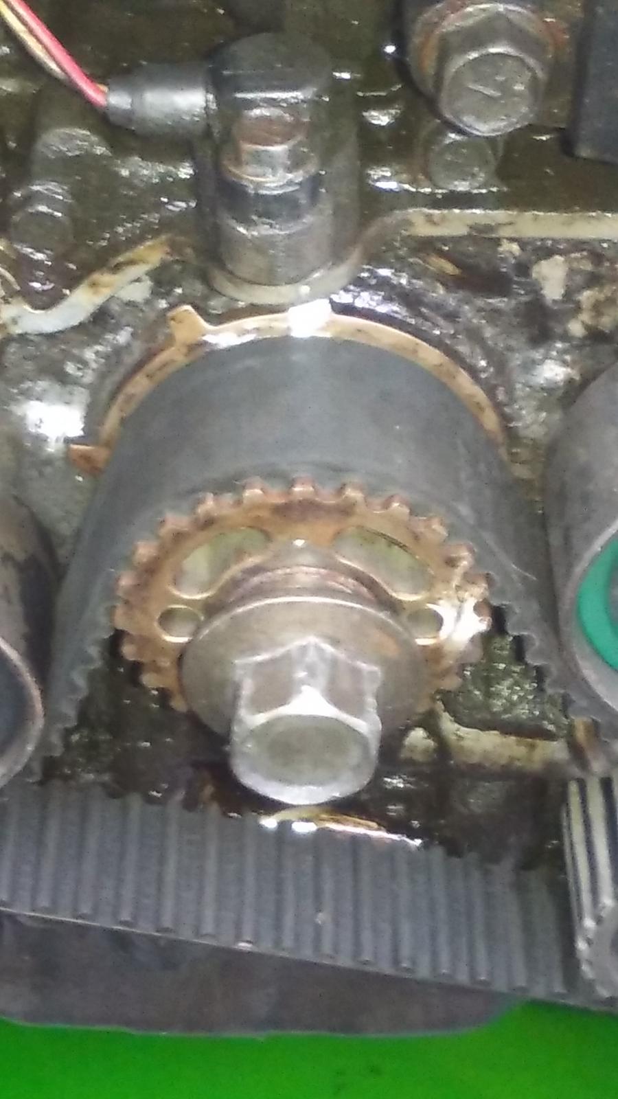

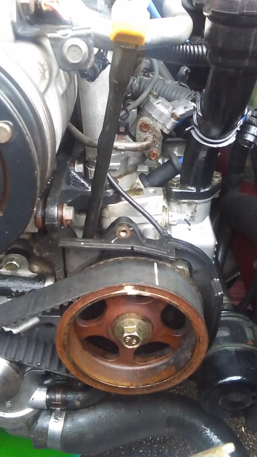

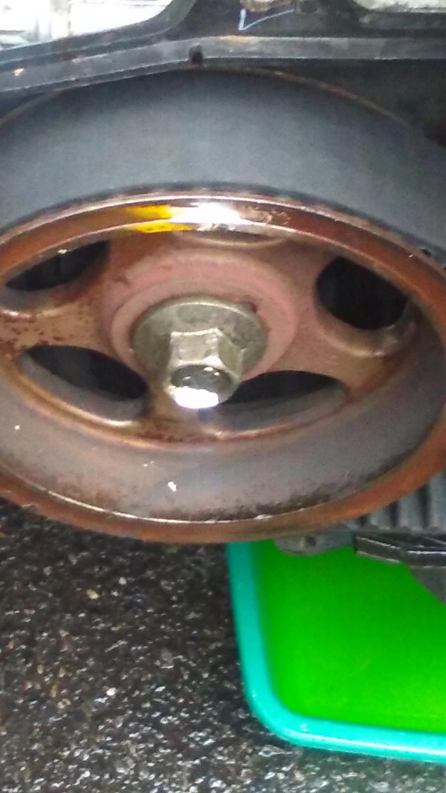

need help spent $400 last week because of a blow n go  2 tow jobs and a lock out code 90 legacy 295k gotta make 300k me and dw  and dog coming home from dinner  car dies pull over  try to start get  that no compression  sound thinking timing belt .Tear apart  was a water pump[bads] caused timing belt issue  miss blow n go reading car is locked out .My fought im old cant see put belt on use arrow on crank gear [bbrrrr] wrong dummy pay $50bucks  to blow n go people for a lock out code good for 4 hrs  car   docent start .Find pictures w hat i did wrong .Tear back apart  put together crank gear mark at 12[arrows at 3  have to have towed to blow n go place to avoid  a violation you cant try to start it  push it in blow n go place they read it  thinking im cool im driving home  it dosent start have to have towed home again its getting spark as far as fuel i undid hose on fuel filter its right there  it had pressure any ideas  what it could be thanks bill
Check your timing marks again.

Hard to tell in the pics but it looks like the drivers side cam may be off a bit. I see something just about 1/2" to the left of the paint on that drivers cam but can't tell if it's the notch mark or just a knick.
Are the notch marks under the paint on yours? Sometimes the notch marks are painted and sometimes not.
Did you remove the cam pulleys for any reason?
