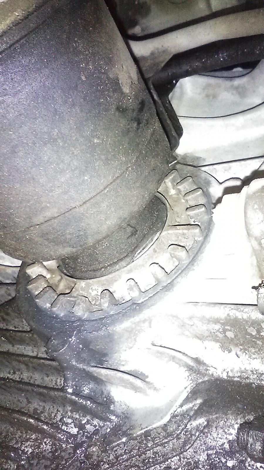

I did notice this
#18 louipaw
louipaw
    Advanced Member
  • 33 posts
  • Arcata, CA
Posted 27 January 2017 - 12:17 PM
Part of the left axle where it enters the front diff

Might be an axle but kinda sounds like a tooth got knocked off the front pinion gear.
Jack it up and spin the wheels and see if anything makes noise.
As I do that while car is off and on park with wheels up I don't hear a noise but it the tranny jolts like an almost up and down movememt
