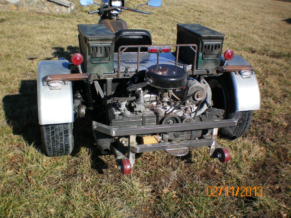

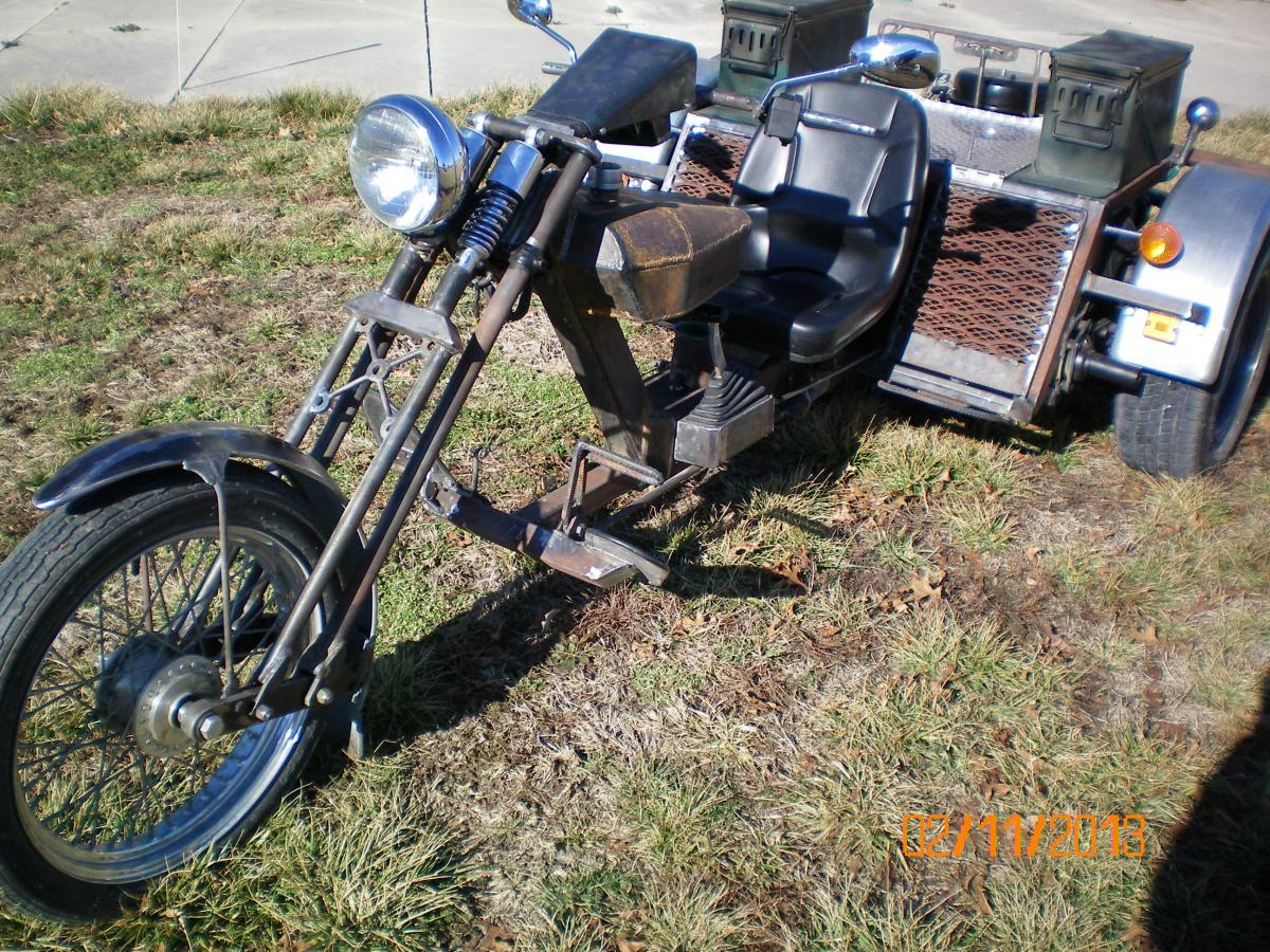

montermahan Posted January 23, 2017 Share Posted January 23, 2017 (edited) This is a trike I built. The cooling arrangement isn't totally my idea, but it works great. It uses 2- 1200 Goldwing radiator's. They work great in all the hot condition's I have been in. They have the original fan's, which never kick on unless I am going slow in traffic, and they cool it down instantly. I'v put 30,000 miles on the used engine with no major problem's. I adapted it to a VW auto with the Kennedy adpator. It was a lot more work using the Subaru engine vs the VW, but well worth the effort. Edited January 23, 2017 by montermahan Quote Link to comment Share on other sites More sharing options...
