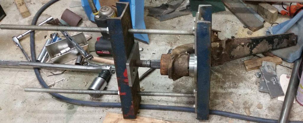

Pressing out axle stub from a spare one, first I ever disassembled.

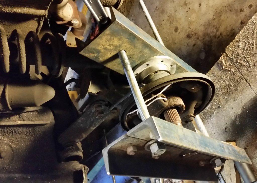

Pressing out stub on car -

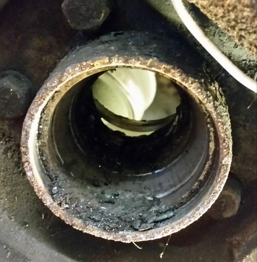

Oooh, nice crumbs ...
Pressing Outer race on car:
