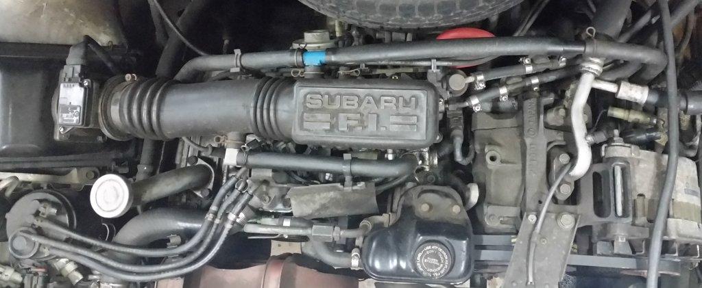

Not a mechanic just barely a diy so please bare with me. so I replaced the timing belts, water pump, and valve cover seals own my ea82 and every thing went great except I took the air breather off to get the compressor off and valve covers off. Now I can't remember how the vacuum line go????. I've got all the the little one hooked up it just the 3 big ones on the driver side and the two big ones on the passenger side goes. this is a U.S model. And yes I know now that was stupid to unhook all that because it was probably unnecessary but o well I'm learning ????☺️

The mod I mentioned is from a technical service bullitin. On cars without it, the rocket cover vent lines go up to the intake boot separately. The drivers side one still has a t to the pcv. But this causes a problem with long medium to high g turns to the right. A bigger line and 2nd t fixes it.
