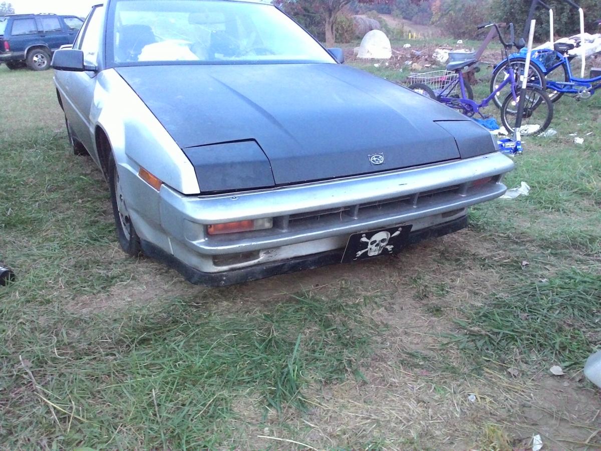

crazyhorse001 Posted February 16, 2017 Share Posted February 16, 2017 So I just realized I haven't done a build thread on my "Little Bit" FWD 87.5 XT GL. I've had her a little over a year now, and have done quite a bit of work on her. I got her cheap and didnt realize that the front end was twisted from a ditch incident by the previous owner. She drove straight and true with no odd tire wear. A few months later the hood latch gave up. This wiped out the hood and windshield. It also spurred me to go ahead and pull out the previous damage. Before After Now she's back on the road to a full recovery. I have a cool paint color picked, and all the stuff to do a 4x114.3 hub redrill, so i can have some nice 15" wheels and low profile tires to make it handle as good as it will look Quote Link to comment Share on other sites More sharing options...
crazyhorse001 Posted February 16, 2017 Author Share Posted February 16, 2017 All my pics didnt load, so here goes... 1st pic: The day I got her 2nd pic:That's how crooked the front bumper was. I used the trailer as a makeshift frame jig to pull it out. 3rd pic: The damage from the hood latch going rogue Quote Link to comment Share on other sites More sharing options...
crazyhorse001 Posted February 22, 2017 Author Share Posted February 22, 2017 (edited) Thought I'd toss up a couple pics of how the car sits now. I'm not gonna mess with the motor or trans, i kinda like 40mpg in a daily driver lol I'm working on a digi-dash conversion and some add on digital gauges to complete my all glass cockpit concept. I have Corvette Night Race Blue paint for it as soon as i get the weather Edited February 22, 2017 by crazyhorse001 Quote Link to comment Share on other sites More sharing options...
