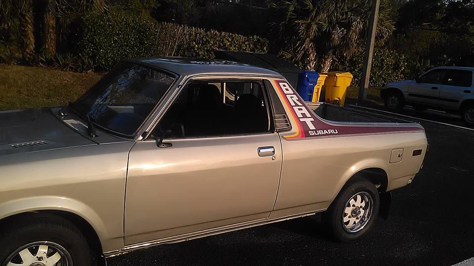

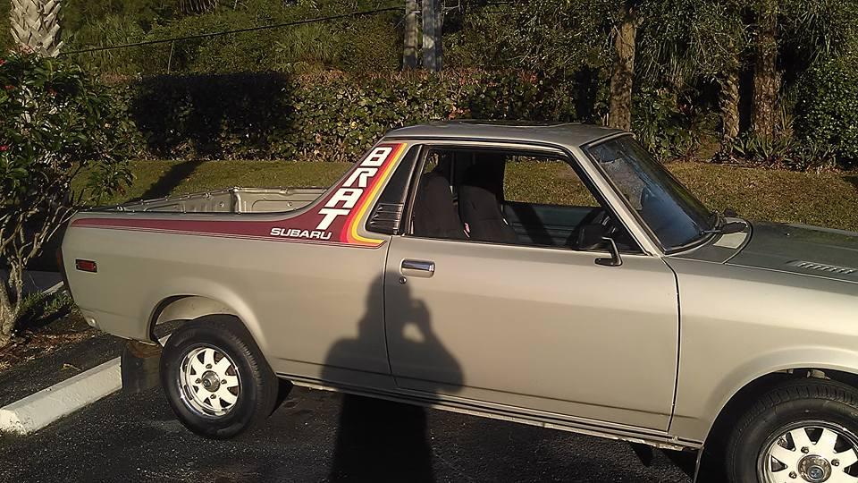

Shes almost complete.. Still have to complete the rear bumper and install.. Decals look great. Thanks Earl!!!

Looks good dude.

Wow..looks really good!

Looking good.

Looks great, I have the same stripes to put on my two Brats! What method did you use to apply them? Thanks

Hey doughildreth.. I actually found a local guy who makes and puts decals on. I didn't do it myself. But I watched him and he sprayed soap water on the car to clean it then sprayed more to get it really wet then peels the back decal paper off and applies the decal on the wet car so he can slide it were we wanted it and then he used a small squeegee like presser to press out the water and bubbles. then he gently peeled the top paper layer off and squeegeed some more.. I didn't want to attempt it myself and mess things up. Decals was a nice $$..
