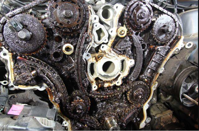

Sorry to hi-jack the Thread.
Really nasty overheated engines will look like a BBQ pit with congealed sludge hanging off things.
Thanks for the info.
Kinda like this Audi engine?
:D
Edited by wtdash, 21 March 2017 - 10:22 PM.
#13 GeneralDisorder
GeneralDisorder
    Elite Master of the Subaru
  • 22,071 posts
  • Portland
Posted 21 March 2017 - 10:55 PM
Exactly - I bought a civic motor that looked like that. They picked it up and had another to me the next day.
