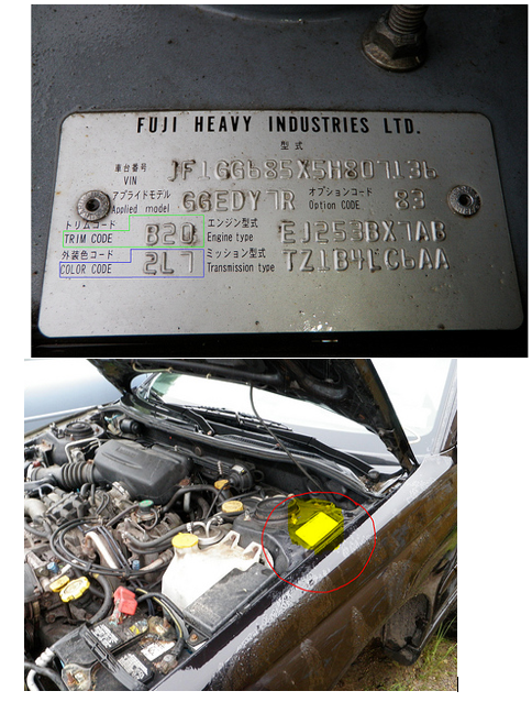

I don't remember the VIN exactly but if you look on the drivers strut tower there should be a metal tag with the original engine and trans ID numbers.
If it starts with TZ it was an automatic
TY means it was manual. Likely it was an automatic since a manual to auto swap is 10x more work than going the other way. Harness HAS to be swapped to go from manual to auto since the AT cars need the TCU and harness and MT cars don't need any of that.

Gary, I just tried the wheel turning method and came up with 4.11:1. I suspected the 5mt to 4eat swap due to doing the wheel turn test, but not being sure I was doing it right and coming up with 4.11 ,and on the firewall in the place where a clutch master cylinder would be, there is a piece of aluminum tape over the hole. According to the plate on the strut tower, however it was equipped with a 4eat from the factory. I am guessing the rear diff was swapped out when the transmission was because the front diff is definitely 4.11. I was under the impression all 2.5 4eat ratios should be 4.44
