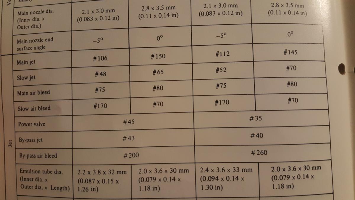

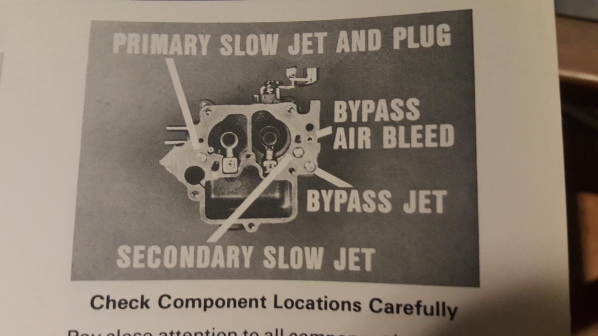

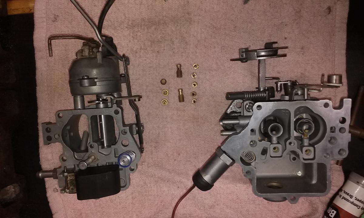

Cocaine Posted April 28, 2017 Share Posted April 28, 2017 I'm rebuilding a 79 brat carburetor and have forgotten where all the jets go. On the right there are 5 jets numbered; 70, 75, 80, 175, and 200. the left has 2 numbered 103, 155 and a plug. the center ones are labeled 45 and 70. Thanks for the help. 1 Quote Link to comment Share on other sites More sharing options...

Willy Fisterbottom Posted May 1, 2017 Share Posted May 1, 2017 Classic Subaru Network (4x140 or GTFO): https://www.facebook.com/groups/1603473039901513/ Hitachi Training manual.pdf Quote Link to comment Share on other sites More sharing options...
