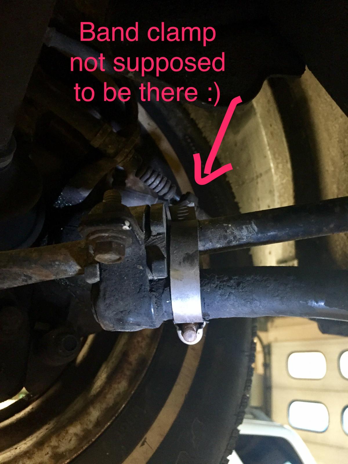

BRATsified Posted May 12, 2017 Share Posted May 12, 2017 Please see attached picture. I get a lot of rattle/play/movement where the leading rod(?) links to the sway bar. [Found a band clamp down there which appears to be a bandaid by prev owner to try to resolve problem.] Any ideas where I can find a new leading rod bushing and perhaps even the metal retaining plate around the bushing? Or anyone have one to get rid of? Or perhaps I could use something in place of an OEM bushing that does the trick here? Thank you, kindly, for any help whatsoever. Quote Link to comment Share on other sites More sharing options...
86BRATMAN Posted May 12, 2017 Share Posted May 12, 2017 721047060 is the Subaru part number for the bushing you're looking for. I can't find the number to the bracket at the moment. 1 Quote Link to comment Share on other sites More sharing options...
