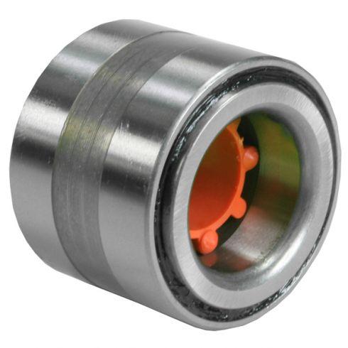

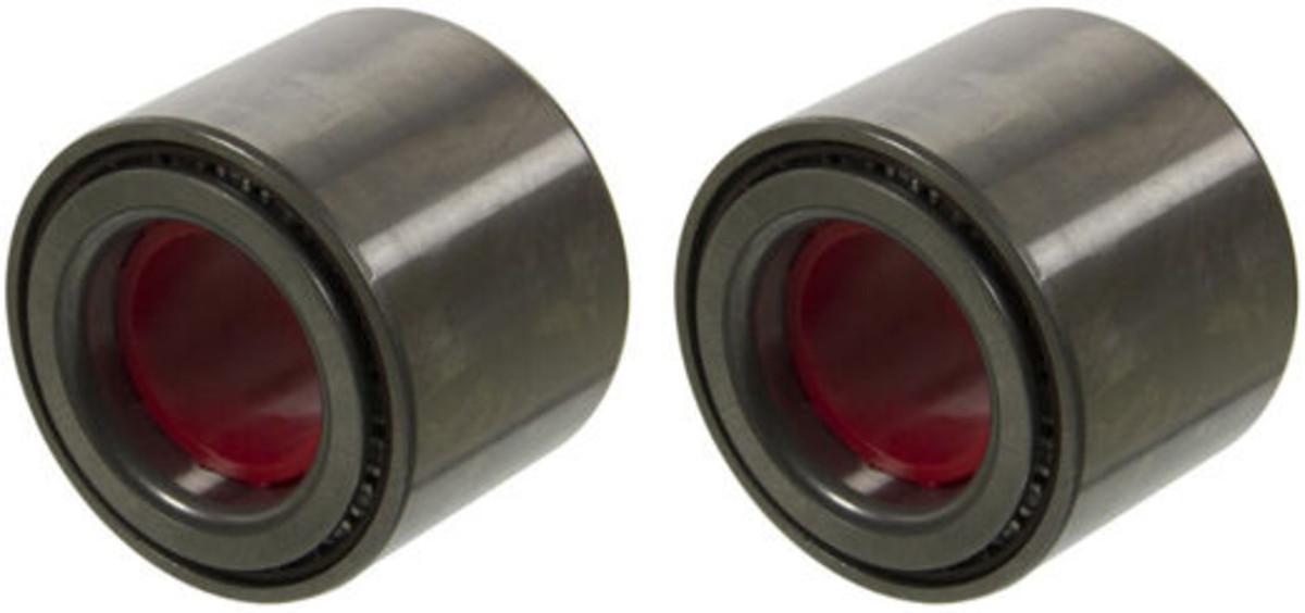

The thing that helped was buying a wheel bearing from Subaru.  The new ones have a bit of a reduction in the middle of the bearing making it easier to install.  The cheap Chinese bearings do not have that feature.
post-25532-0-93347300-1499122089_thumb.jpg                post-25532-0-15525000-1499122306_thumb.jpg
Chinese Ones                        Subaru Style

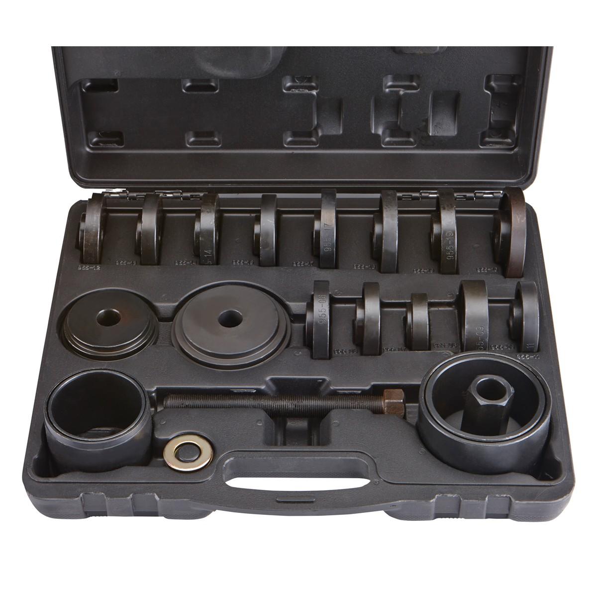

I used my Harbor Freight bearing kit to install the new bearing and hub. Worked like a charm.
