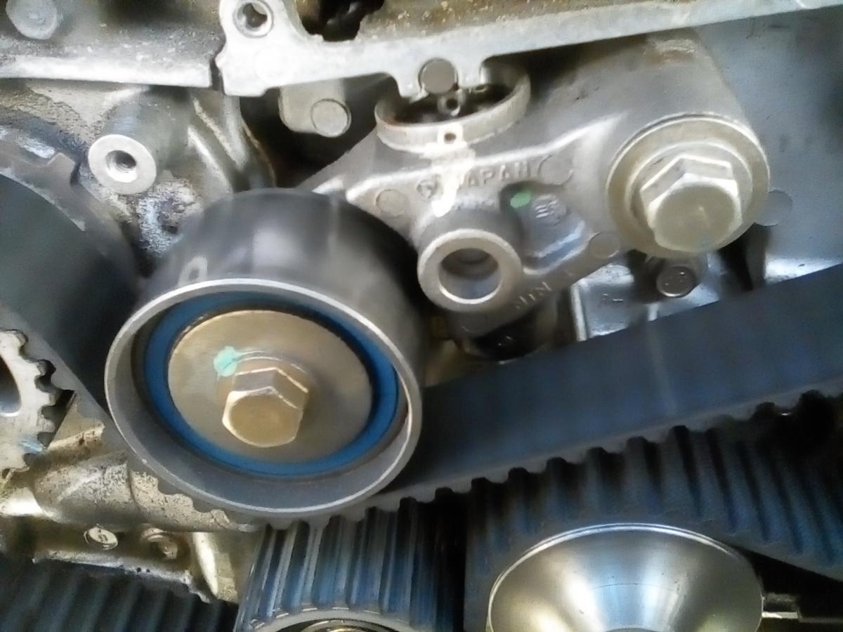

Hectus77 Posted July 4, 2017 Author Share Posted July 4, 2017 I just pulled the timing cover, i will go outside and take a picture of it just to make sure i will order the right part. Another question, what is the interval on changing timing belt, and waterpump? is the rollers and tensioners and everything ment to be changed with every belt change? mine has low milage, or kilometer rather, 112000km or 70 000miles if i converted correct. The rollers and everything seems in very good condition by visual inspection, but i havent taken the belt off yet so i dont know for sure until then. Thanks again for your help. Quote Link to comment Share on other sites More sharing options...
Hectus77 Posted July 4, 2017 Author Share Posted July 4, 2017 Here is a picture of the tensioner, i hope you can tell me wich type/year that is. Quote Link to comment Share on other sites More sharing options...
86BRATMAN Posted July 4, 2017 Share Posted July 4, 2017 Absolutely always change the idlers. They are the more common fail point in the timing system. I've seen more bent valves because of idler failure than actual belt failure. Even though they may look good while installed I'd bet the bearings are noisy when spun uninstalled. The water pump is recommended to be changed as well. Subaru changed the recommended interval in the 90s, some were on a 60k mile schedule and then they upped it to 105k miles. For my own vehicles I try to do the job around 80k just for piece of mind. Quote Link to comment Share on other sites More sharing options...
Hectus77 Posted July 4, 2017 Author Share Posted July 4, 2017 The tensioner roller is changeable right? or do i have to buy the entire tensioner? the tensioner itself seems to be pretty expensive so i rather not change that unless thats also recommended. Also hydroulic tensioner is new to me, is there anything special i need to do to take out the tension and re-tension it? will it be a pain in the butt to get the timing belt on correct again if thats slack? Quote Link to comment Share on other sites More sharing options...
86BRATMAN Posted July 4, 2017 Share Posted July 4, 2017 I don't know of anyone who sells the roller for the new style tensioner. It's worthwhile to get the whole timing belt kit, with the tensioner and everything included. The newer style tensioner can be damaged very easily when compressing the piston back in. Quote Link to comment Share on other sites More sharing options...
