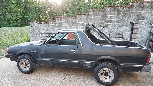

Bratastick Posted July 28, 2017 Share Posted July 28, 2017 (edited) I'm hoping this one will allow me to mount the jump seats. It looks like some I've seen in dealer brochures. I've also got a brush bar that looks similar to the dealer brochures, it does not go around the headlights, just the center. Edited July 28, 2017 by Bratastick Quote Link to comment Share on other sites More sharing options...

Naked Buell Posted July 31, 2017 Share Posted July 31, 2017 So I took a gen 1 roll bar and had to scrap the brat but kept the roll bar and custom fit it to sit in my gen 2 Brat. And I made it to be able to remove easily if needed. But in all honestly, I would just build what you want to fit Quote Link to comment Share on other sites More sharing options...
65stangy Posted July 31, 2017 Author Share Posted July 31, 2017 I think I want to pattern mine after a first gen version. I looked at a u-tube video from 1984 that showed a new brat with all the dealer options on it, and the high top roll bar just looked out of proportion with the brace pipe going all the way to the top bar. Made it look too bulky. Naked Buell, what did you have to modify on the bar that you retrofitted? Quote Link to comment Share on other sites More sharing options...
