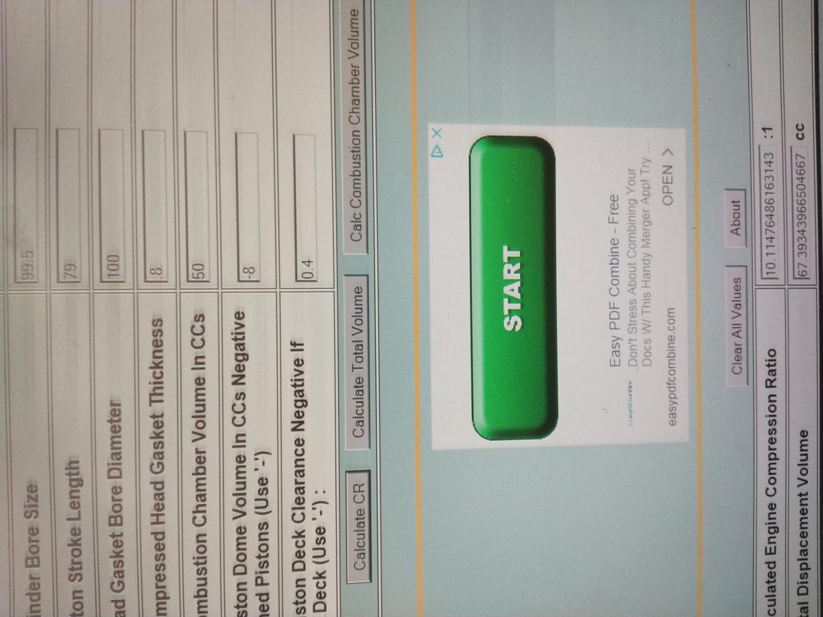

The dome volume you have for those pistons isn't correct, try running that exact calculation with a 0.026" gasket and 50cc combustion chamber and see if that comes out anywhere near 10:1.

I'm trying to get you to reverse calculate the proper piston dish for the ej251/3, which has a 50cc combustion chamber. If you do that you'll see they have an 8cc piston dish. Plug that number into your calculations for the 22e heads and you'll get the correct compression ratio for your combo.

If I use all the same data as before with a 8CC piston dish the compression drops to 8.1
If I use the data you suggested in your first post with my original data than the compression is 7.49
#30 iluvdrt

If I type in the bone stock numbers for a complete 253 using a +8 piston dome it says the compression is 7.49. I don't think that dome volume is right Bratman. EJ253 is 9.5-10:1
If I use all stock data for a 253 with a -12 dome its 9.25 which is way more realistic. -16 piston (which is what replacement pistons are) is 9.7:1. and that is with stock 253 heads and 0.026 quench. That's pretty realistic as well.

https://www.google.c...3_6lk0HLJDPXO3c
Hopefully that link copied correctly. This is a pretty accurate and easy to use Subaru compression calculator.

So the dish is -8 and not +8? I was using +8

11.88 using your chart with 41CC heads and a piston dish of 8. If that's the case, guess Ill have to tune it.

That's what I came up with as well with, it's definitely not a combination I'd recommend running on a stock ecu. If it weren't for this going into an ea81 chassis I'd recommend going to 25d heads because the compression bump isn't as drastic. But that opens up another bag of fitment issues with the timing covers and frame rails.
