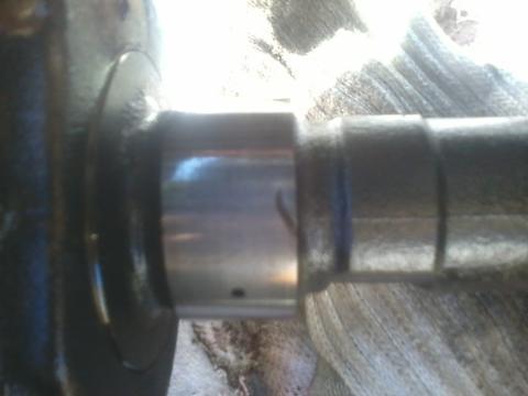

I just took off the valve cover on what I think is the problematic side of the engine (cylinders #3 and #1, the passenger's side.) Attached are some photos. I don't quite know what to look for, but my untrained eye doesn't see anything obviously wrong.
Rear of the engine (cylinder #3) is to the left in the photo; front of the engine (cylinder #1) is to the right in the photo.
Primary view of one valve spring, rocker arm, and cam lobe for cylinder #3, below...
Primary view of the other valve spring, rocker arm, and cam lobe for Cylinder #3, below...
Do you see anything of note in the photos?

worn valve guides would not cause a no compression result.  I mean they might be worn......but that's not the problem.....not part of the combustion chamber.  They seal the valve stem, not the chamber.
you need to check that the valves are closed....which they look to be from pics but you'd have to measure to tell for sure.
But everything in my mind is saying cracked piston/blown ring land.

I just finished tearing down the engine enough to remove the cylinder heads. Check out the photo below of the exhaust valve for cylinder #3 (to the right in the photo.) The valve has got that chunk missing, and both valves are caked with carbonized gunk.
Well, that explains the systems: no compression on cylinder #3, burning oil out the exhaust, lack of power.
The #3 piston doesn't appear to have damage to it's surface.
I have another set of cylinder heads that are being serviced by a shop. Before I put those on though, I'd like to get to the bottom of why the valve broke in the first place. Any thoughts?
Jason
