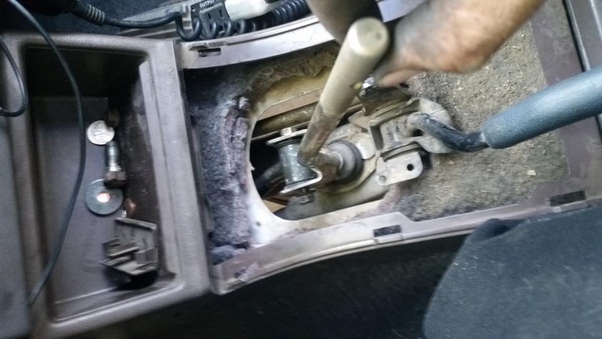

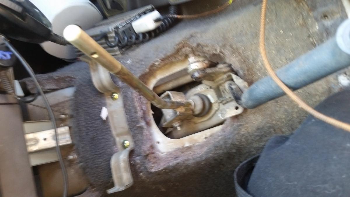

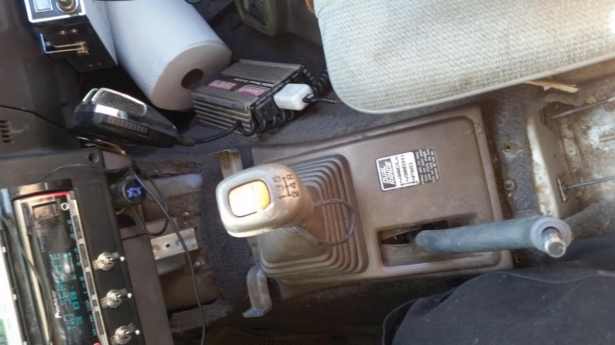

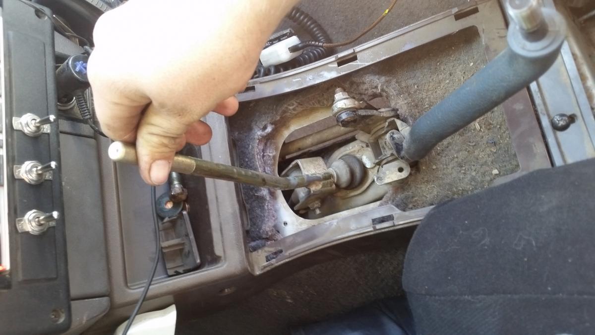

So I put the single range shifter in because I want the button for my light bar, it actually shifts into gear fine now which is strange. But you can definitely see something is crooked. It is angled towards the driver side as if the whole linkage assembly is turned or bent but it doesn't look bent wrong. You can see in the second picture how turned the shift knob is when it's correctly on the shifter (holes line up for the pin)

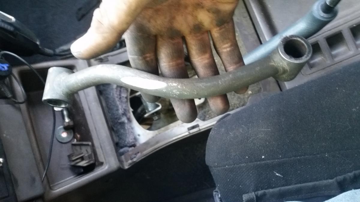

You can see where this one hit other linkage turns out you can't see it while it's on the car and I must have missed it before but it's got 2 kinks in it. Also I put my single range one in and it works fine??? I thought all the linkage had to be dual range?
that shift linkage is bent.  perhaps the stay rod is bent too?

You can fix that.by using the adjusters you can see in your picture there are 2 plates one conected to the shifter and one to the body and there bolted together you can see the top of the studs in the pics the holes are biger in the plate that mounts to the body it can go any direction about a 1/2" just loosten the 2 bolts and give it a twist tighten it back up
