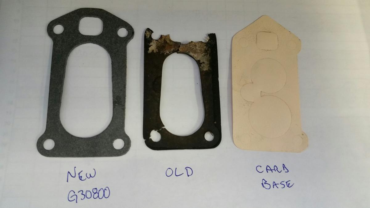

Hello..  I have a 1979 Wagon with a 1.6  E81 stamped engine.  I have identified the carb as a Hitachi dcj-306-8 .  Im struggling to find a carb to manifold mounting gasket.
Aftermarket listings show a Mahle part number of a G30800.  I have ordered this but is too large.  I can not seem to find a part number for the gasket that will work.
anyone have any ideas on a part number?
Please help!
Attached photo-  left is the new gasket which is too big,  middle is whats left of the original and the right is an imprint of the carb base

I know I can find this gasket in a kit but curious if anyone knows a part number for this base gasket as just the single gasket?

Nippon Reinz Part Number:W0133-1643681-NRZ

Thanks Naru,   That gasket part number worked great!!    my local parts stores listed that Mahle part number as the only option, napa and oreillys which was wrong.
