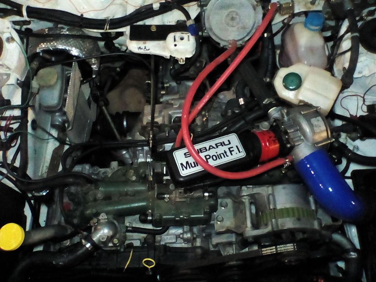

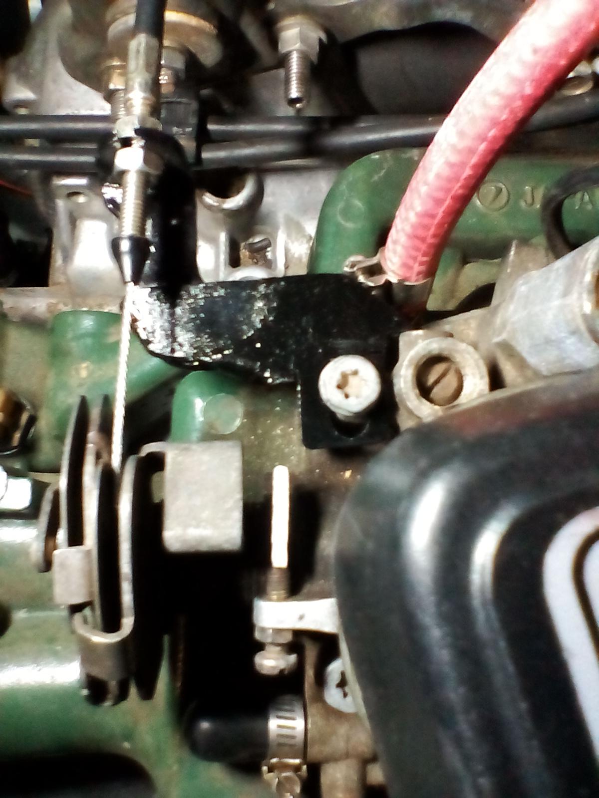

Pictures speak a tousand words and I left it out
Story to this post is I discovered an error of mine.
I made a bracket for my LHD acc cable in my rhd ute. When I had to alter it I still forgot to check it did not interfere with throttle opening
I discovered it did, massively!
I could get a six mm drill bit between throttle body inside and the brass butterfly at max throttle. Six point five was too big.
A quick fix with hacksaw and caliper paint gave full throttle. Now this how I recall my mongrel
In aus we got lots of multi point injected ea82 in XT, in royals ea82 sedans and touring wagons all non turbo
My short is from an 87 touring wagon that I parted up with pristine 188,000 km. The heads are twin port turbo heads with longer stem exhaust valves. The inlet is from turbo coz needed to block off turbo coolant line below thermostat. It now runs impco 200 mixer and L converter and 22* btdc @800 rpm
My new saas tacho says idling at 1400 rpm.
It has this on cam like burst of energy at 6000 rpm. Heard from a guru ( Hi Greg) that hydraulics won't operate well above 6500 rpm, so starting to doubt new tacho when it tells me I hit 8000 rpm in second of five of my 87 touring wagon manual part time 4wd box whatever ratio it is on 175.70.13 tyres. Saw 80 kph at 8000 in second. I have an air filter box from aGM 3800cc v6 car and 2.75" induction tract

OK the thumbnails above taken with this non phone device...a pad? One shows where I marked throttle pull can with white corrector. The black bracket was wider away from body and white was stopping on it to give minimal throttle. Still ran quite well. Just acc pedal not hitting floor as they do in rhd....wheel well gets in the way

Well mister, please share the things you did to your last ea82 natural aspiration build with us here. I have already shared mine being short block from carb 87 touring wagon, heads are from a turbo so has longer stem exhaust valves, oil feed and return blocked off.
Intake is mpfi twin port. Exhaust is ea82 efi y pipe then factory ea81 tiny stuff so is quiet. All the noise is from induction via Impco 200 mixer and box air box and panel filter. Impco throat is 2.75". Run 22 degrees timing @800 rpm. My fuel is about 109 RON. Highest pump fuel here is mostly 98. Some places have 100 and ethanol 85 is 107 RON
No flow work done to heads. Cams could be anything ...early turbo grind comes to mind.

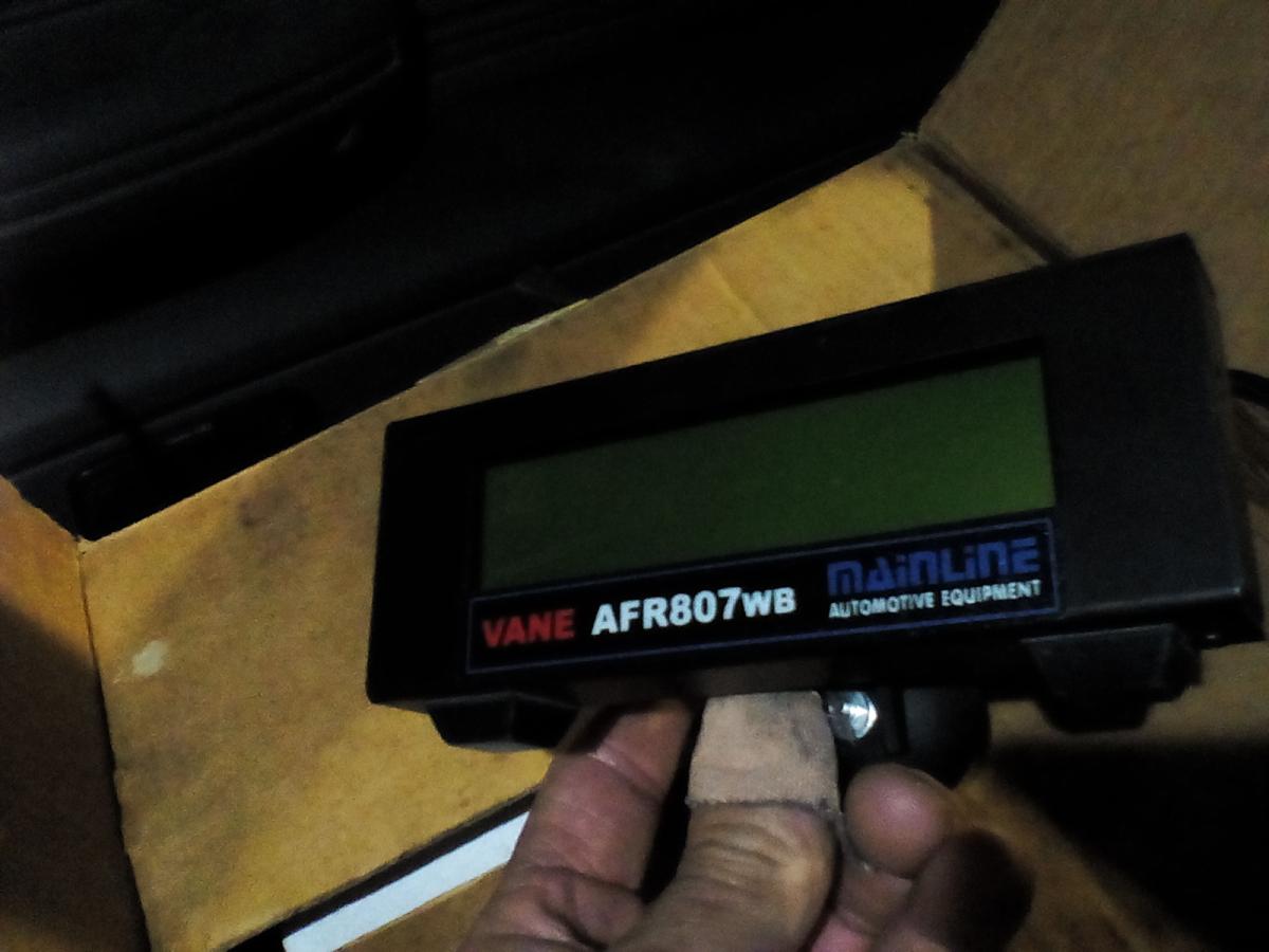

I called mine a mongrel coz it is a mix of parts from different ea82 configs. The dizzy is a carb unit so with spring clips to retain cap, so not screw down dizzy cap of the injecteds. It is a 4WD carb dizzy from 87 model. It has what is described as the twin modules in it. You'd likely need a manual to get its advance details. I am running a tuning LED O2 reader and it says running lean but can't recall if this reader by Peel Instruments is the one I adjusted to reflect the tail pipe analyser
