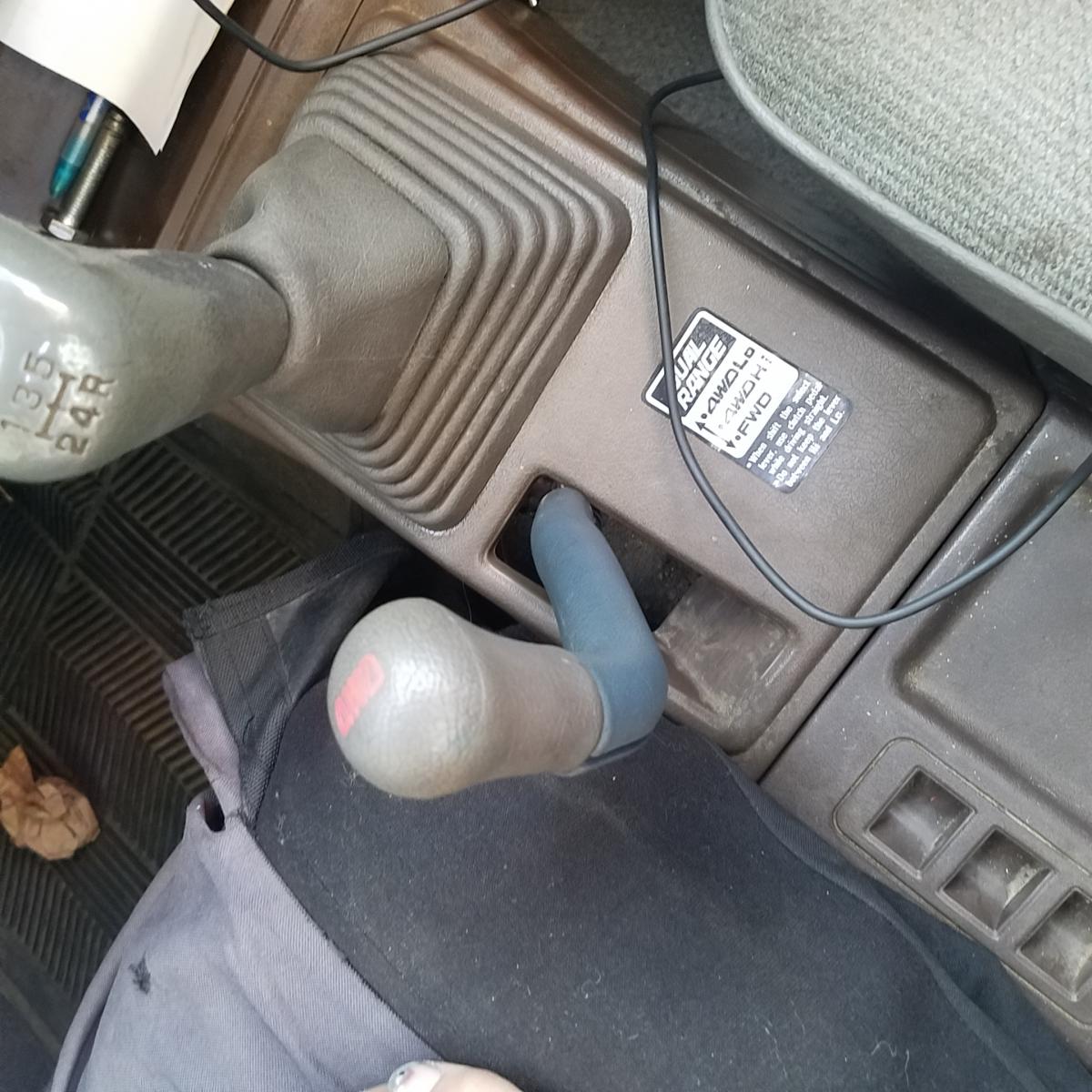

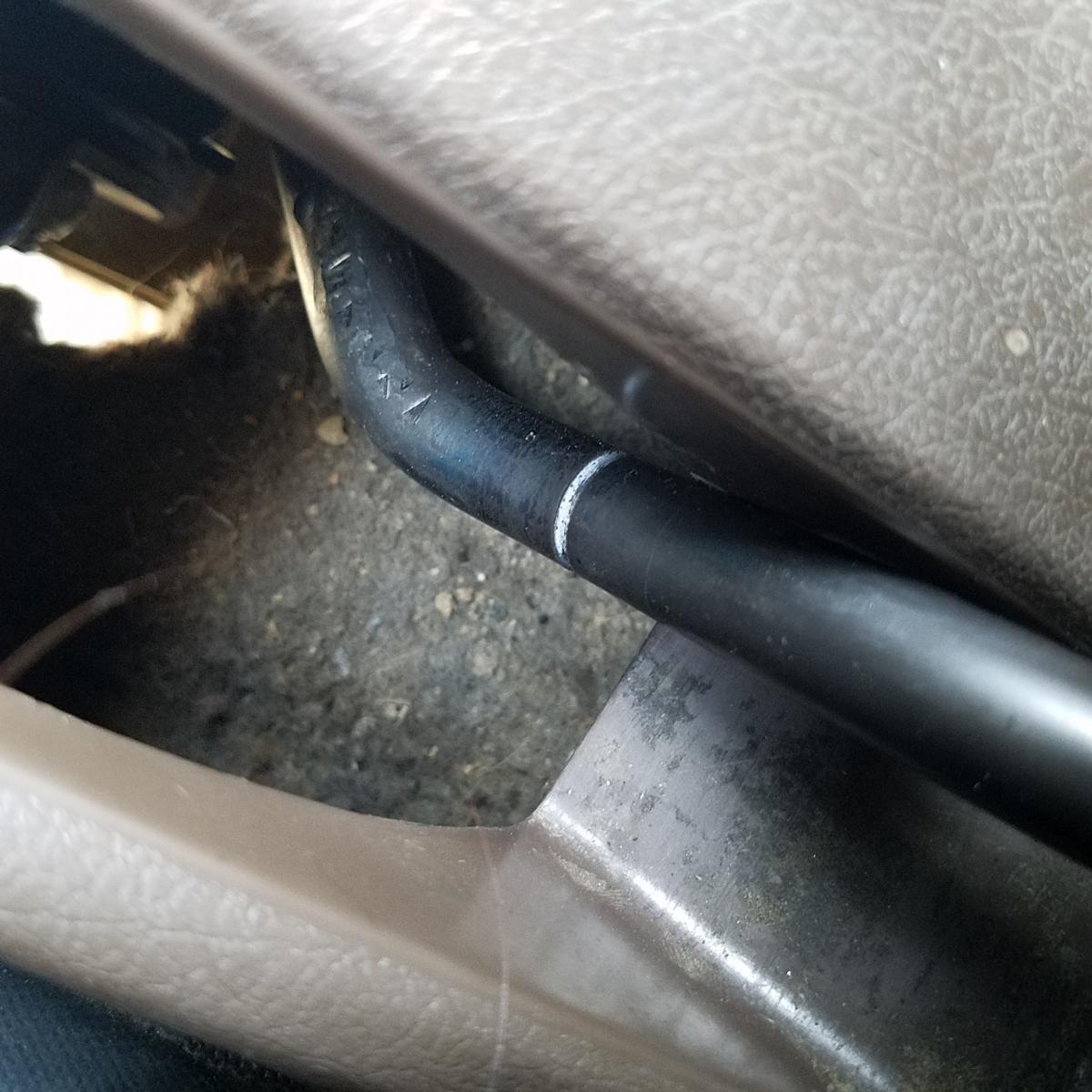

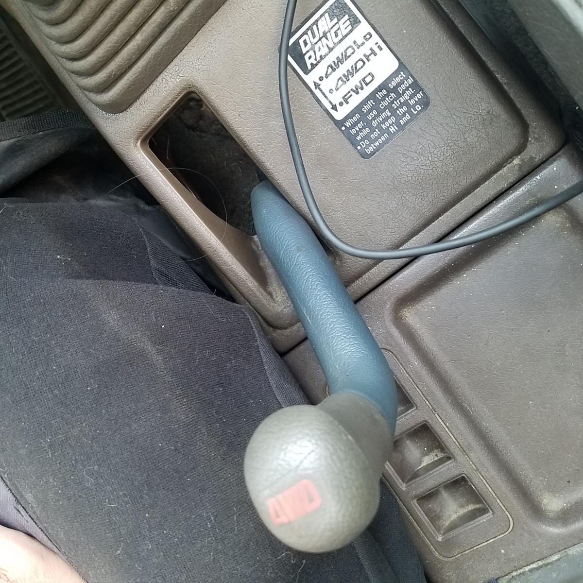

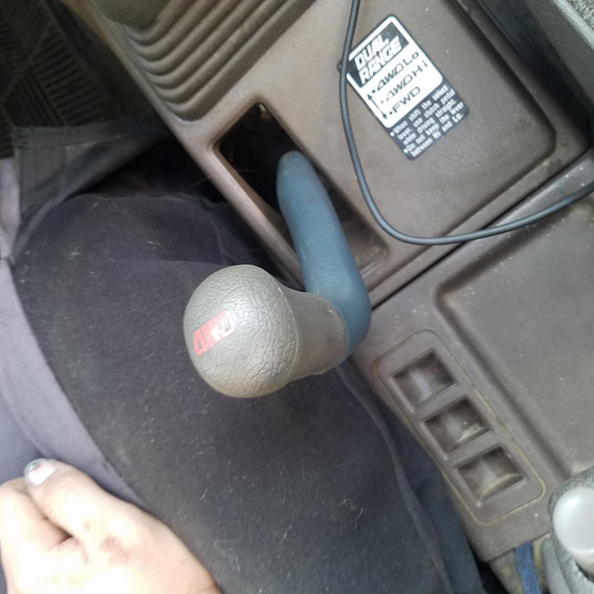

XHighOctanex Posted September 19, 2017 Author Share Posted September 19, 2017 Took it to a buddy's, used a forge bent easy it's in perfect now Quote Link to comment Share on other sites More sharing options...
jono Posted September 19, 2017 Share Posted September 19, 2017 Can we see some photo s please? Quote Link to comment Share on other sites More sharing options...
XHighOctanex Posted September 19, 2017 Author Share Posted September 19, 2017 Can we see some photo s please? Yes I'll grab a couple before I go to work Quote Link to comment Share on other sites More sharing options...
XHighOctanex Posted September 19, 2017 Author Share Posted September 19, 2017 You can see it is bent pretty much perfect, but I'm pretty sure the car I got the linkage from was screwed up because the shifter is off to the right like the actual bar is bent somewhere so I'll probably get another when I find one Quote Link to comment Share on other sites More sharing options...
djellum Posted September 20, 2017 Share Posted September 20, 2017 (edited) I used a torch on mine. you dont need a hammer, just clamp some vice grips on the shaft and use them for leverage with your hand. I pulled the seats completely out and took the console completely out so there was plenty of room, and removed the rubber from the lever. I put a metal box in the drivers side where the seat goes to set the torch down if you need to, even if you turn off the gas the torch head is hot enough to damage. doesnt take much at all, kiss the metal where you want to bend with the torch, pull away the heat and bend it with your hand. I put the torch out and in the box to reset the vice grip and restarted everything for the second bend. you have to make 2 bends, placement is up to you. one goes up, then the other bends back down to get the lever flattened back out to its original angle. I left the rubber off of mine for extra clearance, and because I eventually want to cut the shaft to have the knob run just outside of the console to have more console room to put a cup holder. Edited September 20, 2017 by djellum Quote Link to comment Share on other sites More sharing options...
