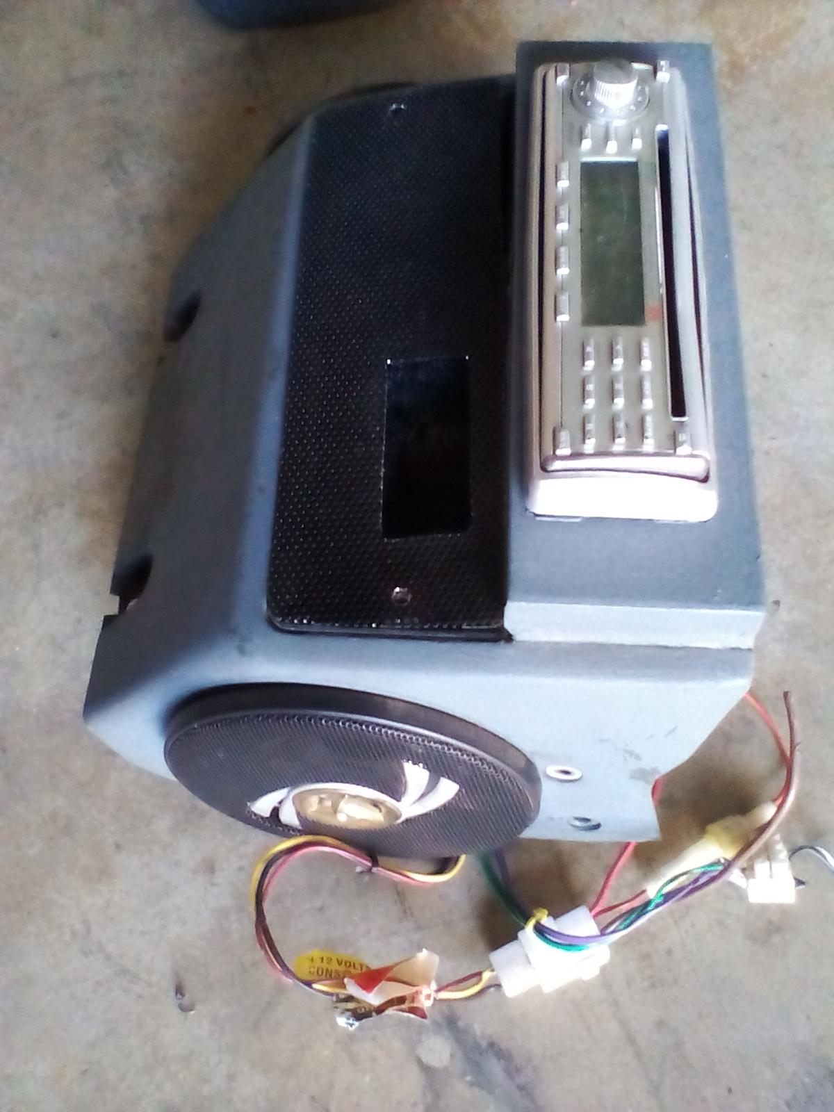

Just thinking of how others modify their radio consoles in today's era. A lot has changed since Subaru brought us throw away cars that just aren't ready to be thrown away up to thirty years later.
Below are two of mine. The one with CD playing device has my front speakers housed in its sides

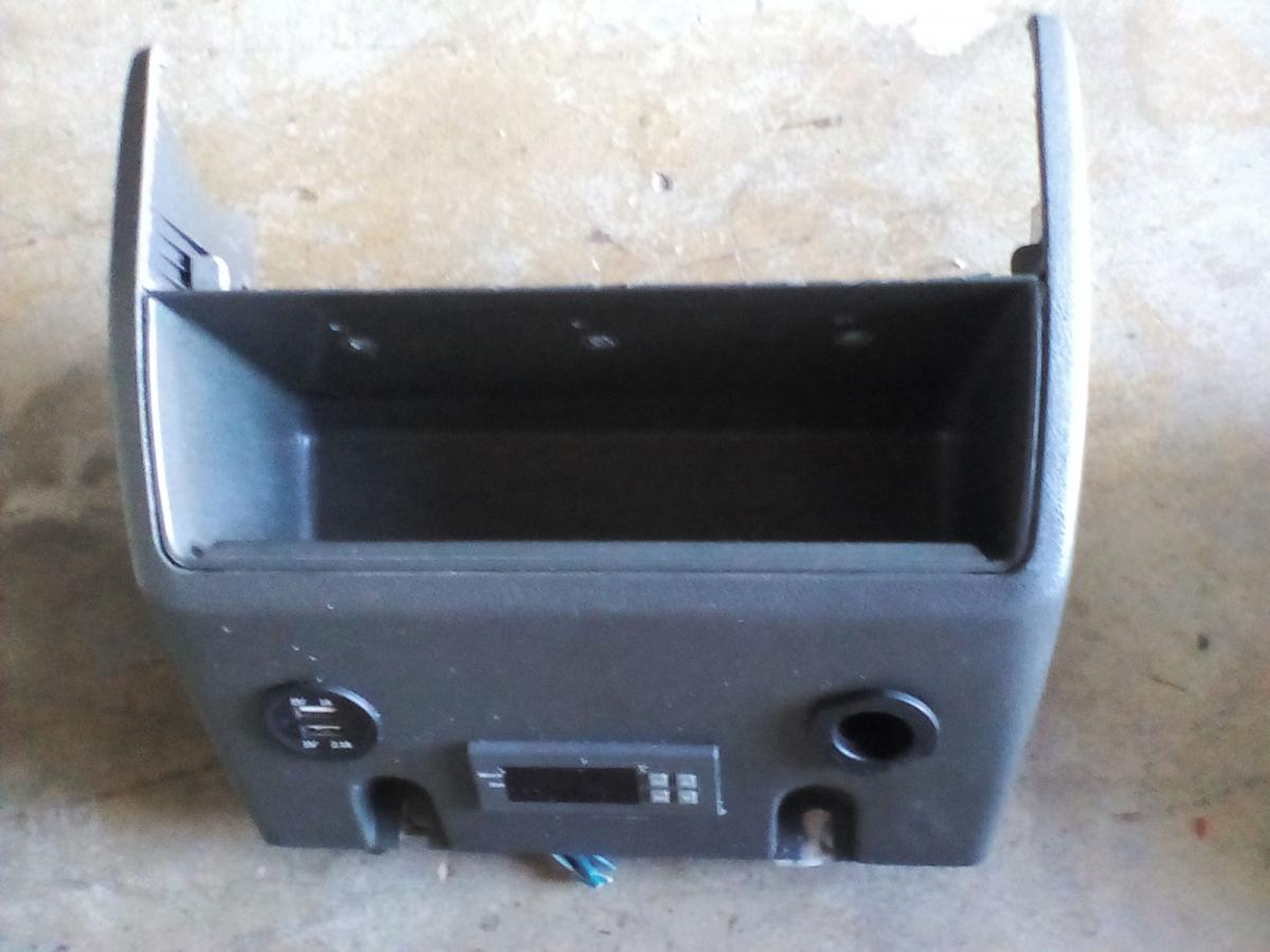

The other has not yet got its entertainment device thought out but has a passenger side power supply which will be std CIG socket and other side will get this double USB power socket.
I have EA82 gearbox and console so have a gap of about 65 mm between radio console and gearshift console so can access these power sockets. The other unit is a Chinese made temp unit alarm or switching device I will use to read engine metal temp to switch fans at my preferred temp of 85 to 90 C. Gonna use another for cabin or ambient, maybe another to monitor propane converter to alarm before freezing from coolant loss
Show us your console changes yeah?

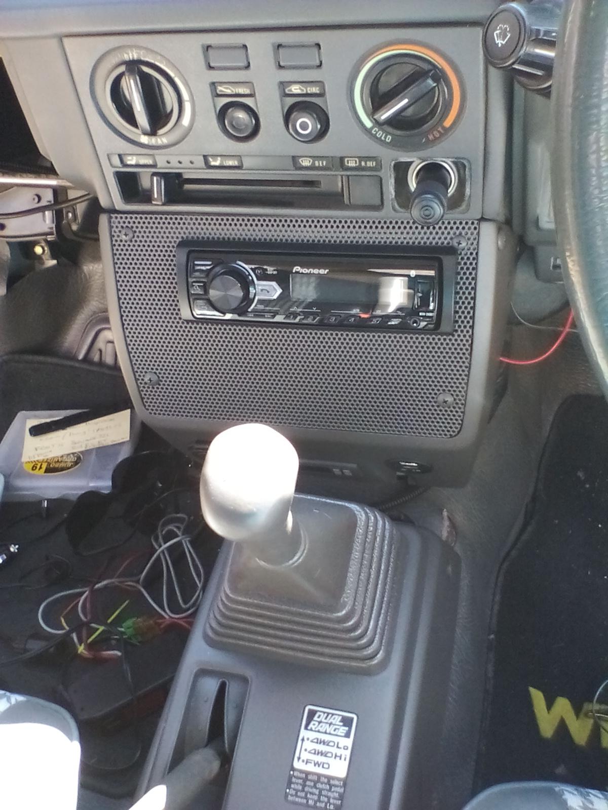

I ended up hitting it with not quite dark gray vinyl paint, and it looks pretty neat if I don't say so myself.
I cut the entire hash tray and radio fascia out, made a brace across the top behind the mesh and employed a plastic, textured push pin trim plug each side. I nearly splashed out on a DIN sized front speaker for below but could spend pennies better.

thanks :) I made use of the gap that occurs when using a particular L Series console after dropping the L Series five speed DR box in with no lever cuts. Its nice not having console bucket contents on display too having an L Serie lid as well :)
I added a std power socket to the passenger side to make use of the not central set up so long plugs and straight cord does not interfere with other console sections, and a twin USB port on driver side, and a little ebay temp control device between them, really only visible when head is on flor but it will scream at a temp set by me, think 95 C it is. All this stuff has been kicking about for years just waiting for me to make the time
