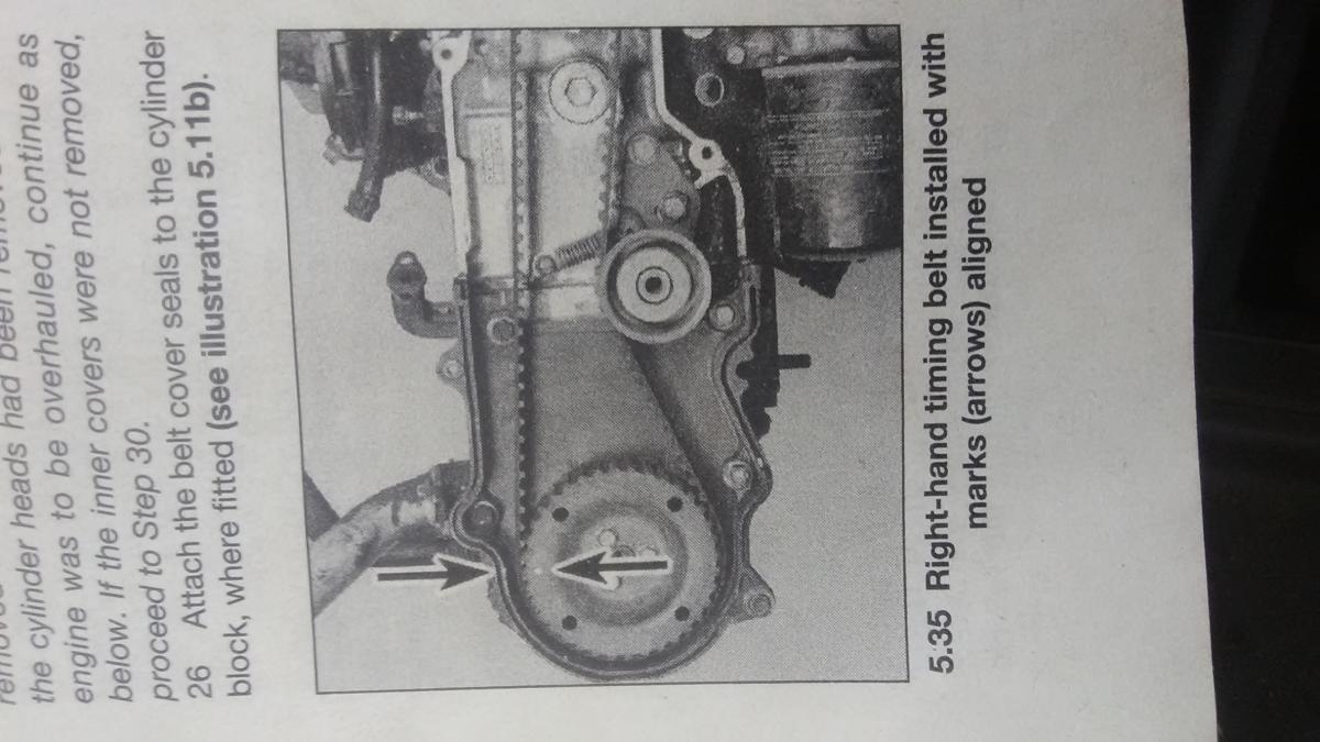

I'm not sure where these three marks are. Looking at the illustrations in a Haynes manual, I see there should be some dots to line up. Is that what you're talking about?

The three timing marks are on the flywheel. There's an Access cover right behind the intake manifold. Should be a rubber cover. Pull that and rotate engine till you fine 3 lines grouped together with no numbers. The numbered lines are for the distributor timing. The in marked three lines are for the timing belt timing
