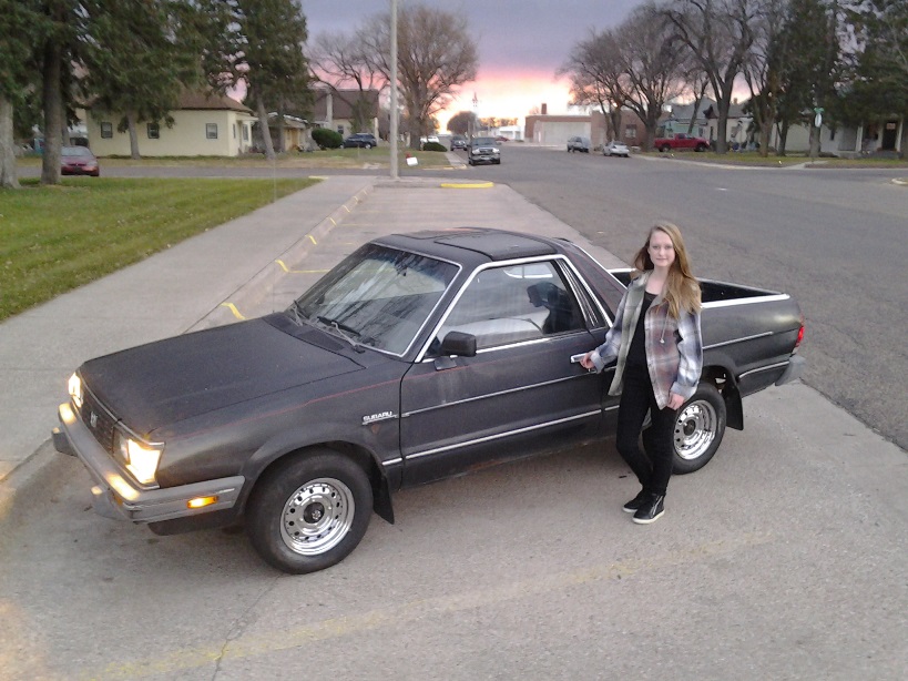

IT RUNS!
Absolutely correct the new FPCU made no difference.  But, I did want to have a new one to verify functionality.
I also got *another* new distributor.
So what's different?
Absolutely nothing.
Every circut, wire, component, etc. tested out exactly as before.
I have no idea why it is running now, and why it wasn't running before.
Here's how it happened.  I tried the new FPCU. Nothing. I put the old one back.  I put in the new distrubutor with new ignition module.  Nothing. I was ready to tow it to the dealership, open up my credit card, and give them instructions to "make it run".  That's when my wife forced my daughter to come out and help me with her car.  I proceded to show her everything I tested and did to her car to make it run without success.  She was bummed.  As I was cleaing up, the only thing I hadn't tried was to run a wire directly from the batter to the (+) side of the coil to bypass all of the other wiring through the car. So I pulled the (+) lead off the coil and replaced it with the wire directly to the battery.  I did that and it immediately started.  So then I went back through the circuits thinking the ignition switch was at fault and maybe I hadn't tested to make sure the coil was receiving power when the strater was cranking.  I verified that.  So I still had no idea why it wasn't running. previously, but I went ahead and set the timing again as it got dark.
This morning I went through everything again to verify I was getting power to everything I was supposed to get power to when I was supposed to get it.  It *should* run with the (+) ignition wire attached to the coil without the jumper.  I put the (+) ignition wire back on the coil as I had done innumeral times before.  Nothing initially, then it fired after I pumped the throttle once.
That's where things are now that I've put evetyting back together.  It runs great and starts with no issue.  And I have no idea what the difference is.

Did I not suggest direct power to coil quite a while back? And you only just done it?
You could a left car out fro t thinking no one would or could pinch it....some punk rocks up with his hot wire none the wiser toyour woes, bust the steering lock and hhe's got a getaway car!
I have chased a few electrical dead ends and its my fault did not tell you Murphy was an auto elec
A mate says sometimes two plus two equals five
Years back I was just trying to get rear I dictators to work looking for a break I powered lights from socket back to switches. Could not find fault. After the reverse power up ran fine until cars end!
Just recently my power antennae stopped going up. I plugged my spare ant into the loom to see it worked. Plugged loom back to dead ant. Decided to work again just like that
Your daughter must be impressed now with all the new components and her dad.
Well done. Now you qualify to answer trouble shooting posts!

With as much time as I've put into this vehicle over the last several months, I don't even want to look at it. And I still need to get it to a local shop to replace the front half shafts (a project that snowballed from a single torn front CV boot), the poorly constructed replacement exhaust probably needs to be completely redone, and the replacement windshield I had a body shop install is leaking and has cracked following the recent temperature fluctuations. The same shop broke the first replacement windshield trying to install it. The windshield rubber is very had to find, and any replacement chrome trim in the rubber is impossible to find. I may end up taking it to another place if they want to charge me for another windshield.
At least my daughter is happy being able to drive it as-is for a few days before it heads to the shop again.
