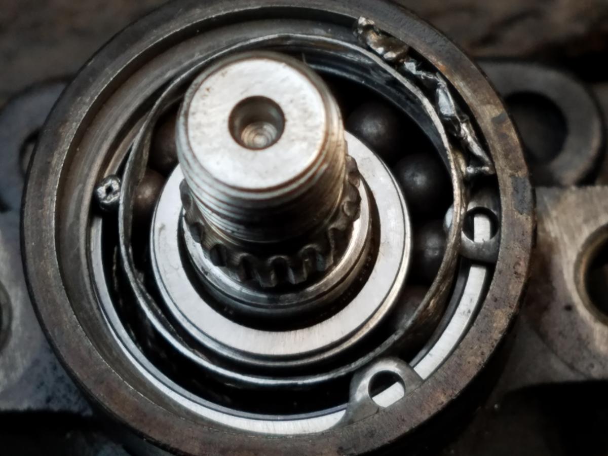

Found it. Bearings were shot, shaft wobbled, stamped sheet metal keeper between the balls got caught, bent up, and pieces jammed the balls and stopped it. Couldn't detect the wobbly bearings by hand. Need a crow bar to try to wiggle it with belt tension present.

I'm sure it's better to remove the belts, but more likely to be actually checked if I can just quickly put a bar in there and see if it wobbles. Wondering if it is possible that the actual cause of the problem was the stamped metal keeper wearing out by rubbing on the balls, then bending and jamming in the balls. If the balls are not evenly distributed (that's the job of the keeper), they could clump together and allow the shaft to wobble. I don't have any idea how many miles were on it.

Sounds like you are talking about the cage. It's the stamped part that keeps the balls spaced evenly. Normally don't wear, but if there was no lube, it won't last long. I have not dissasembled one of those pumps, so I don't know if the bearings are lubed buy the ps fluid, or are sealed ones like on the water pump.

If there was a rubber seal, it's no longer there. The view in the picture is what you see when you remove the pulley hub. Now that you mention it, I have no idea how the bearings are lubed.
They are a sealed brg like on water pumps.
Chances are the grease had dried out which then took out the balls then the cage then the seal. All it would take is one ball seizing to start the snowball rolling.
Easier to get a reman pump than find a kit for them.
