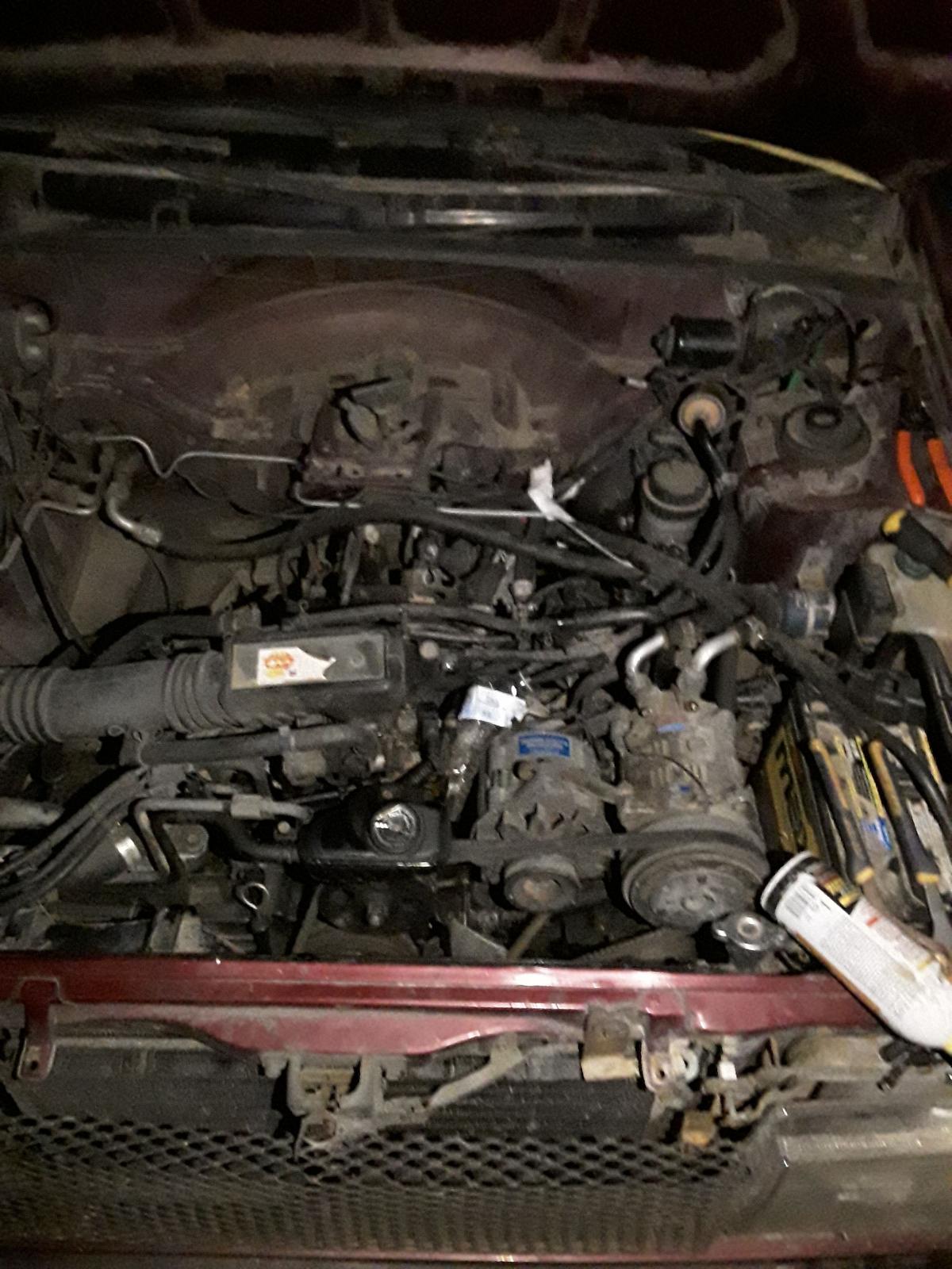

#11 DaveT
DaveT
    Subaru Nut
  • 3,725 posts
  • Colchester
Posted 21 November 2017 - 11:35 PM
If it's a carburetor, it will have an odd shaped metal air cleaner case on top of the carb..
If it's SPFI, the rubber boot on top of the throttle body should have SPFI embossed in the rubber, and the air cleaner is a box on the fender, side opposite the battery.
MPFI I haven't seen, they were not common.
Turbo, well, there is a turbo somewhere near the engine.
Alternate  - take a picture of what's under the hood, and post it.

#13 Jakethewhite
Jakethewhite
    Member
  • PipPip
  • 29 posts
  • Visalia CA
Posted 22 November 2017 - 12:05 AM
Here it is

#15 wagons
wagons
    USMB is life!
  • 131 posts
  • prescott az
Posted 22 November 2017 - 07:23 AM
Ok you have have a spfi. It's a fuel injected engine
