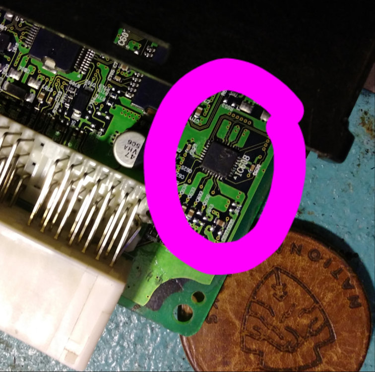

I verified you guys are right. Gotta bring car, new ECU, and key fobs to Subaru dealer to get it all programmed. Can't plug and play with ECUs, at least not on the '06 Tribeca. Can't just grab another ECU and throw it in and expect the car to run.
I have checked wiring extensively but didn't check for voltage on the ground pin for injector 1 at the ECU. Just go from the ground pin to ground, correct? Won't I have some voltage drop across the injector?

In a properly operating circuit you'll see the voltage drop Only if the ECU is grounding the circuit. With key On,You should see 12v at both pins on the injector (plugged in) and you should have 12v at that injector pin on the ECU.
Voltage only drops across the load when a ground is present. With no ground, voltage will remain the same all the way to the end of the circuit, or the point at which the circuit is open.
So if/when the ECU grounds that injector circuit, the voltage will drop to near 0.
If you have 12v reaching the ECU with the key On, start the engine and see if that voltage fluctuates with the engine running. (Presumably the ECU will be pulsing that injector ground to spray the injector) Steady voltage at this point will confirm the ECU is bad.
If you have no or low voltage reaching the ECU, that will mean a break or poor connection in the wiring.

I have 12 V at the ECU both with key on and with it running. No fluctuations - no grounding of the circuit to cause the injector to pulse.

Ok, now as a final check to rule out a short to voltage, while checking voltage at the ECU (key on) Unplug the number 1 injector. Voltage should drop to 0.
If voltage stays up there is a short to voltage in the harness.
It's not easy for an injector driver circuit to burn out unless there is a short directly to supply voltage (no load, thus high current passing through the circuit) or an internal fault in one of the components in the circuit. What you don't want is to install a new ECU and have the same problem because of an issue in the harness that caused the old one to be damaged.
So with the injector unplugged if 0v showing on the meter, wiggle the major parts of the wire harness all around and make sure the voltage doesn't jump up instantaneously, due to a temporary short.

Update: Found a used ECM on ebay. Took car, key fobs and ECM to a dealer. Dealer reprogrammed new ECM. VOILA!! Problem fixed!
So apparently this was that 1% probability that the ECM failed shortly after the head gasket work and the two problems were unrelated.
Definitely goes against reason, but hey, it's fixed now...
